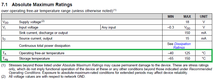

Hi team,
My customer would like to know the junction temperature of TLC555QDRQ1.
we can only find the junction resistance from the data sheet.
Could you provide the junction temperature of TLC555QDRQ1?

Alex,
The ambient temperature maximum is 125C. The storage temperature is 150C. During storage TA=TJ so junction temperature is also 150C. Operating junction temperature must not exceed the storage temperature. Maximum junction temperature is 150C. Clearly the minimum operating junction temperature is -40C
