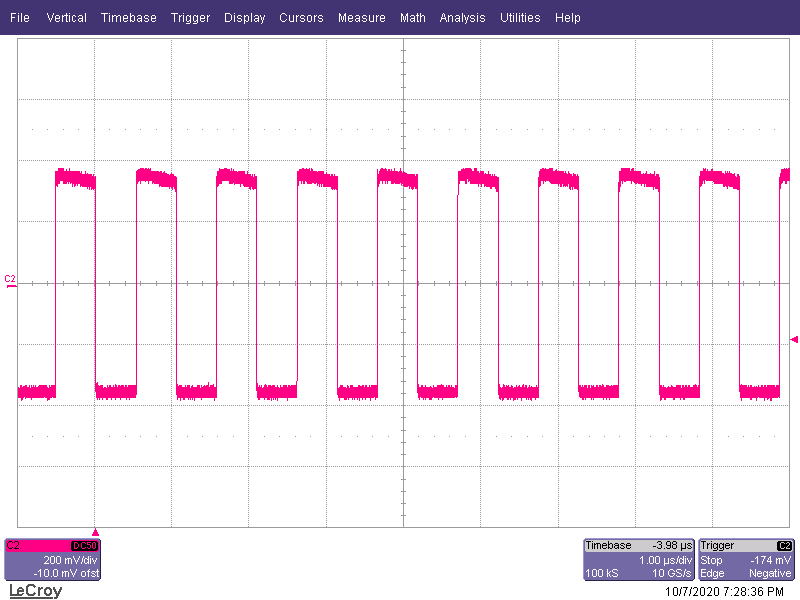

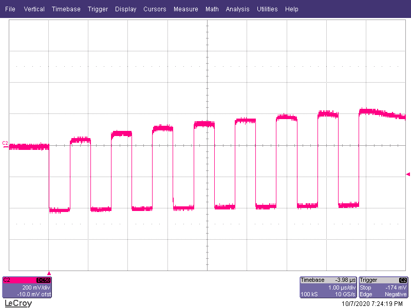

    3. Regarding the SYSREF. I tried to work with the eval board and I have few questions:
    a. Each ADC + FPGA should get a SESREF signal. Should they all be synchronized to the same clock edge? if yes which clock ?
    b. I saw in the data sheet that I need to adjust the SYSREF delay (analog + digital) in order to keep the setup+hold time constrain. I do not understand how this should be done in reality and why the PLL does not take care of it. In general, what is the method (if required) to synchronize two SYSREFs ?
    c. I connected the SYSREF of CLK1 output (set to LVPECL 2V) to a scope and ran it in two modes: continuous and Pulse. I have also few questions about this:
    i. It looks like the signal at the output charging a capacitor cause I see the signal amplitude increases over time (it can be easily seen at the pulse mode). In the continuous mode you can see how at the end the signal stabilize. Is it because the eval board ? the PLL chip? (see attached pictures)
    ii. I tried to operate  the SYSREF by changing the polarity of SYNC_POL but it did not activate the pulser. What did I do wrong. The only way to activate the pulser is by pressing the "Send Pulses" button in the SYNC/SYSREF window.

    3ci. It looks like the signal at the output charging a capacitor cause I see the signal amplitude increases over time (it can be easily seen at the pulse mode). In the continuous mode you can see how at the end the signal stabilize. Is it because the eval board ? the PLL chip? (see attached pictures)
    The eval board has AC-coupling capacitors on the SYSREF path.
    Yuval Minster said:
    3cii. I tried to operate  the SYSREF by changing the polarity of SYNC_POL but it did not activate the pulser. What did I do wrong. The only way to activate the pulser is by pressing the "Send Pulses" button in the SYNC/SYSREF window.
    If you click "Send Pulses" you'll note the SYNC_MODE mux is set to SYNC SPI (pulser) mode. If you want SYNC_POL toggle to trigger SPI pulses, you need to set SYNC_MODE mux to SYNC Pin (pusler) mode.
