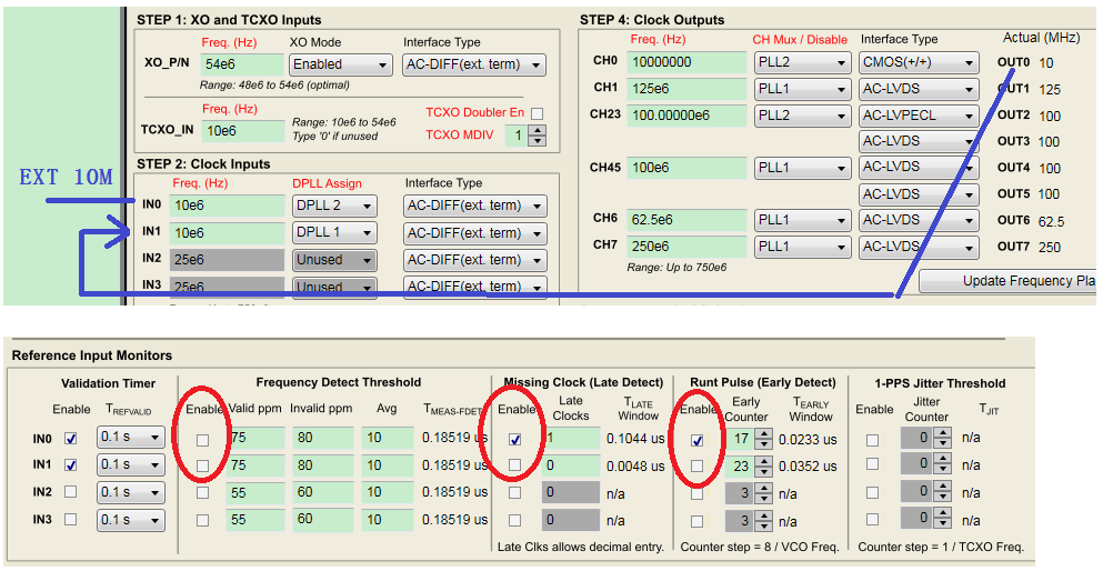

  • Hi Amin,
    Sorry for the misunderstanding. This spur is from another clock device coupling by space. And removed by switching off the clock device. By saying "unlock", I mean that the DPLL2 is unlocked. We also set the 0xBB to be 0xd, but it seems that it didn't work, the DPLL2 is still unlock when spur comes.
    We want to know if there is a config that can avoid the unlock when spur comes.Thanks.
    So the spur observed at an output from the DPLL2/APLL2 loop, causes DPLL2 to be unlocked? This spur is from another device that's on the board. Is this device close to the reference input?
    To understand what's causing the DPLL2 to unlock, we need to know a few things, is the reference DPLL2 trying to lock to, valid? Does DPLL2 select that reference? Here's the GUI image where this data can be found, if you hover over it it will also tell you register numbers and bits that correspond to this info:
    If the reference is invalid - we'd need to understand what part of the validation checks is causing to become invalid when the spur is there.
    If it is valid, the DPLL should be locked unless it's a bad configuration. Which shouldn't be the case since you mentioned if there's no spur the DPLL is locked.
    Thanks and regards,
    Amin
  • Hi Amin,
    30.72M comes to the device by the REFIN0 and you can find the tcs files as attached.
    When there is no spur and input 10M 0dBm reference into REFIN0, the register status is as below:
    0x2E6 -- 0x30
    0x2FF-- 0x02
    0x303--0x01
    DPLL2 loss of lock: 0  DPLL2 lock
    DPLL2  REF0 selected 1 selected
    When there is 30.72M spur and input 10M 0dBm reference into REFIN0, the register status is as below:
    0x2E6 -- 0x20
    0x2FF-- 0x02
    0x303--0x00
    DPLL2 loss of lock: 1  DPLL2 unlock
    DPLL2  REF0 selected
    After removing the 30.72 spur, the register status change to the status in the 1st step(no spur status).

    Thank you for the information and sharing the .tcs file. So when the spur is there, it's IN0 is no longer valid.
    I noticed in your .tcs file that IN0 can support either DPLL1 or DPLL2 based off of inputs however for DPLL reference selection only IN0 has a priority. If this is changed, the DPLL2 can lock to IN1 as well. How to update the priority selection in the GUI with image at the bottom of the email.
    The question of why IN0 becomes invalid and IN1 remains valid is understood now as well. IN0 has PPM detector enabled. Not sure what the requirements for the system are... but you can disable IN0 PPM detector or at least increase the invalid threshold. The spur is causing enough noise where this is becoming invalid.
    On a similar note, I would advise that missing clock is enabled - there's no harm in this and it would allow DPLL to realize a loss of reference much faster and enter holdover before corruption or large frequency error can occur.
    Thanks and regards,
    Amin

  • Hi Amin,
    1. LMK05028 IN0 from EXT 10MHz input,lmk05028 IN1 from lmk05028 out0 10MHz 1/2  Vpp, so we can just check DPLL2 IN0.
    2. You can find the tcs file as attached (lmk05028 BTS 10Hz fae 1016)
    disable Valid IN0,
    Enable  missing clock (when late clocks =0, input check is valid, so set it to 1 )
    Enable  runt pulse
    3. When there is no spur and input 10M 0dBm reference into REFIN0, the register status is as below:
    0x2E6 -- 0x30
    0x2FF-- 0x02
    0x303--0x01
    DPLL2  REF0 selected : 1 selected
    4. When there is 30.72M spur, reg is as below(no change of the reg,DPLL2 unlock):
    0x2E6 --0x30
    0x2FF-- 0x02
    0x303--0x01
    When switch off the spur, the reg recover to the status when there is no spur
    5. When enable missing clock late clocks=0, and 10M 0dBm ref input to refin0 and no spur:
    0x2E6 -- 0x20
    0x2FF-- 0x02
    0x303--0x00
    DPLL2  REF0 selected : 0
    lmk05028 BTS 10Hz ae 1016.tcs
    Thanks for the details. I would just like to confirm I understand correctly:
    1. No spur - DPLL1 selects REF1 and DPLL2 selects REF0 - both locked
    2. Spur added - DPLL1 selects REF1 and locked - DPLL2 has REF0 as valid and selected, but DPLL2 is not locked
      1. This is with no input validation enabled basically, correct? Since next step is saying Late and Early enabled.. I'm assuming this is with no PPM detector and no missing clock, so really input may be valid but in actuality we're not running it through any validation
    3. Final case: Enabling missing/early - only REF1 is considered valid (REF0 isn't valid) - DPLL1 selects REF1 and is locked - DPLL2 is showing locked yet the reference selection is "holdover"
      1. Loss of lock is only tied to frequency lock and therefore will no get flagged if device was previously locked
    One more thing I've noticed, why is the output type CMOS (+/+) yet input is AC-DIFF(ext. Term). CMOS (+/+) would provide outputs with both n and p in phase.
    • If using singled ended input, you can change the selection to LVCMOS and the change the channel output to CMOS (+/Hi-Z) or vice versa since only 1 channel would be needed.
    • If using differential, then output type should be changed to a differential type (LVDS, CML, LVPECL)
    Thanks and regards,
    Amin
    One more thing that's confusing, the picture is contradicting what I've took to understand. OUT0 is feeding IN1 which is going to DPLL1 - so OUT0 cannot impact DPLL2 in any way. In the picture you have DPLL2 is just using IN0 which is an external reference.
    The output type update still applies though - OUT0 CMOS (+/+) will be worse in terms of both performance and spur as well. So perhaps that change can fix the system.
    Thanks and regards,
    Amin
  • Hi Amin,
    Please see the response as below:
    —— yes
    ——  Spur added - DPLL1: lock; DPLL1 ref1 selected :lock (when frequency detect threshold disable,if  enable is unlock)
    ——Spur added - DPLL2: unlock; DPLL2 ref0 selected :lock (when frequency detect threshold disable,if  enable is unlock)
    ——  yes
    —— frequency detect threshold disable, Late and Early enabled :  the result  same ;Spur added and frequency detect threshold enable,the DPLL2 REF0 selected  :invalid
    3.    Final case: Enabling missing/early - only REF1 is considered valid (REF0 isn't valid) -DPLL1 selects REF1 and is locked -
                ——   yes
       ——   Spur added,DPLL2 showing  unlock,APLL2 is lock ; DPLL2 reference selection  "holdover"
    —— yes
    ——one CMOS+ to lmk05028 IN1, other cmos+ to lmk04821 refin0
    o  If using singled ended input, you can change the selection to LVCMOS and the change the channel output to CMOS (+/Hi-Z) or vice versa since only 1 channel would be needed.
    o  If using differential, then output type should be changed to a differential type (LVDS, CML, LVPECL)
    ——    using differential,the refinput  detect sometime is inaccuracy,so TI FAE advise set  differential type  (AC-DIFF interface Type), REFIN1  can change the selection to LVCMOS input ,results still the same
    ——  DPLL2 is just using IN0 which is an external reference,   DPLL1 is just using IN1 which is from LMK05028 OUT0+; DPLL2  impact DPLL1
    ——  Clock inputs IN0/IN1 interface Type set to  LVCMOS/LVCMOS (or other type), results still the same.
    1. Spur added,frequency detect threshold disable,  10MHz  still 5dBm,  lmk05028 has some  filter ciruit to rejector spur ?
    2, Spur added, reset DPLL2 (0x02a5 02-0x02a5 00;0x006003,0x006002),results still the same
  • Again, I'm thoroughly confused. If the spur is on OUT0 - that is connected back to IN1 - IN1 only goes to DPLL1. Why is DPLL2 or IN0 impacted at all with regards to the spur? There has to be something else going on and this is only a byproduct of it that we're observing.
    IN0 and IN1 physically are the farthest away from each other inside the die so that's already the best isolation. If there's a spur on IN1 however it will appear on IN0 to an extent as well... from this information you're implicating the spur on IN1 (which comes from out0) is significant enough that it makes IN0 no longer valid and DPLL2 can't lock yet DPLL1 remains locked somehow to IN1 that has a significant spur?
    IN0 to DPLL2 should be a clean signal I presume so even the cases where you said "threshold enabled" - I'm assuming this is frequency PPM - means the reference no longer is valid can make sense for IN1 if we take it DPLL2 never locked therefore the frequency error as result of APLL2 locking to XO is too large for IN1 to be considered valid on the input stage.
    Just to re-state and make sure I'm not losing something in the details:
    1. OUT0 no spur: DPLL2 is locked to IN0, DPLL1 locks to IN1 which is fed back from OUT0
    2. OUT0 has spur: DPLL2 doesn't lock to IN0 (even though it should be unimpacted) DPLL1 locks to IN1 (even though this has the spur coming from Output0?)
    For all cases let's proceed with Missing clock (late and early) detectors enabled. That's the recommendation. If this is invalidating the input then the input clearly is unstable.
    With regards to frequency PPM we can decided later. If frequency PPM is the invalidating factor, I'd be interested to know how much does the threshold need to increase by for it to be valid.
    • Again with regards to IN1 since it's being feedbacked from OUT0 and DPLL2/APLL2 loop presumably the PPM detector issue would go away if we can get DPLL2 to lock
    Thanks and regards,
    Amin
  • Hi Amin,
    1,Spur comes from IN0, is not comes from OUT0,Spur added  DPLL2 unlock,DPLL1 lock
    2,
    1)   OUT0 no spur: DPLL2 is locked to IN0, DPLL1 locks to IN1 which is fed back from OUT0
    —— IN0 no spur: DPLL2 is locked to IN0, DPLL1 locks to IN1 which is fed back from OUT0
    2)  OUT0 has spur: DPLL2 doesn't lock to IN0 (even though it should be unimpacted) DPLL1 locks to IN1 (even though this has the spur coming from Output0?)
    —— IN0 has spur:  DPLL2 doesn't lock to IN0( this has the spur) ,DPLL1 locks to IN1
  • Ah that makes more sense. Apologies for misunderstanding so many times... the spur is on IN0 the whole time. And the IN0 is not valid if you enable any kind of reference validation (missing clock or reference ppm).
    Unfortunately there's not much we can do about it... you can try different input types perhaps one would be slightly better than others at blocking out the spur but outside of that there's no feature that suppresses it.
    Thanks and regards,
    Amin
