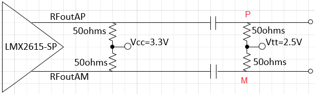

Need to determine Output swing of RFoutAP/M to make sure it's compatible with receiving device and having difficulty using Pout specifications on Pg 8 in Table 6.5 of datasheet (6dBM at 8GHz and 4dBm at 15GHz) and Pout graphs shown in Figure 16 on Pg 14 of the datasheet to determine this.
If you could answer the 3 questions posed in the following sketch that would go a long way towards helping me determine compatibility. NOTE: All Traces In Sketch Are Single Ended 50ohms
Thank You, John
