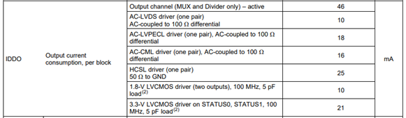

 2)  How much power could I save if I developed a custom program for our application and disabled the outputs for all of the unused clocks?

    2) You may use the information on page 9 of the datasheet to estimate how much power you could save by disabling outputs.
