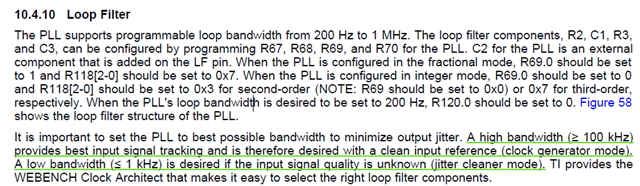

Hi team,
My customer has several LMK03318 used in the development of single-board evaluation. DS shows that the device has two modes: generator and jitter cleaner. I want to know:
1. Does the generator mode suppress the noise of the input clock source?
2. If there is noise suppression effect in generator mode, is there any quantitative data on noise suppression effect in the two modes?
Thanks a lot!
