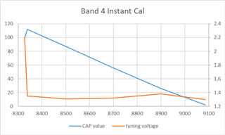

Noel, after I ran instant cal all the returned band/cap values looked good except at the low end of band 4. The plot below shows the abrupt change in cap value and tuning voltage over the first 10MHz of the band. This results in a Kvco change of 2:1 at the boundary. Is there a way to avoid this?
