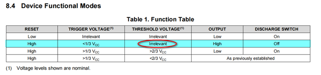

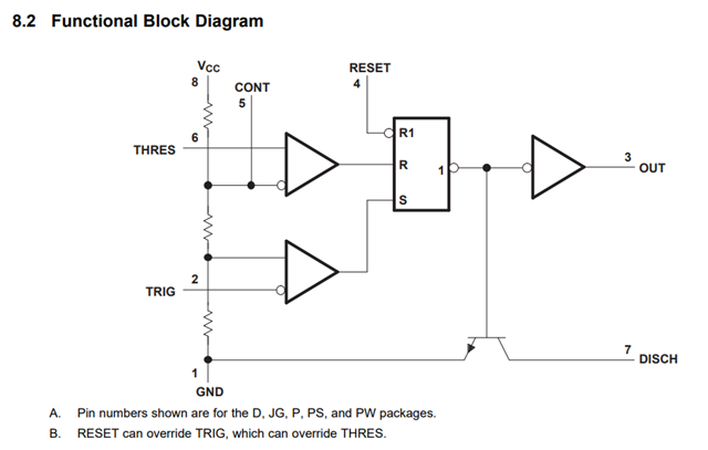

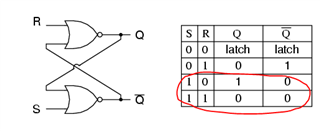

According to the functional Block Diagram of the NE555, which is an RS trigger internally, the output of the RS trigger should be indeterminate when the R and S pins are both high 1.Why does the truth table give NE555 outputs that are Irrelevant to the threshold pin status when TRIG voltage < 1/3VCC?
