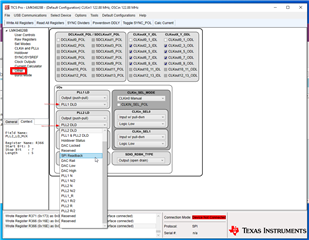

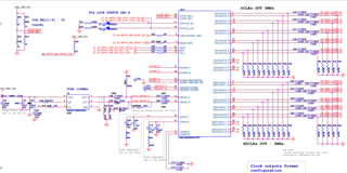

We have a board with LMK04828 and is configured via 3-wire SPI through external wires(length-0.5m). We are not able to see the Output on DCLK's / SDCLK's.
DCLK  -5MHz
SDCLK-5MHz
Any way we can read back from SPI configuration or through status LED?

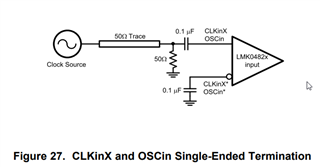

LMK is to be configured in Distribution Mode through CLKIN1-100MHz single ended Sine wave input i.e., 1.89Vpp (9dBm) and CLKIN0 is left unconnected.
The attached below schematic and config file for reference.
CLKIN1 circuit. CLKIN0 left open. CLKIN1 - AC Coupled sine wave (9dBm)
LMK config file:

Please let us know where we are missing.
We have tried capturing the spi signals we do activities on data.
