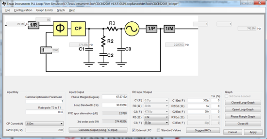

    It is important to set the R3 and C3 properly. I can only do so after I understand your loop bandwidth. THe device has an active loop filter. THerefore, you can set R3C3 such that 1/(2*pi*R3*C3) is 10x higher than your bandwidth. However, the loop filter tool as part of the GUI takes also care of this. Are you running the latest CDCE62005 GUI?
    http://e2e.ti.com/support/clocks/m/videos__files/353682.aspx
    The GUI will be able to calculate the BW. You want to be sure to achieve the following values if you keep the PFD frequency at 370kHz:
    BW < 37kHz (10x lower then PFD frequency)
    Phase margin between 45-80 (I like it right around 65).
    CP current: I recommend using something higher, maybe 2mA (1.5mA to 3.5mA). I would avoid 400uA personally, as a very small current could have the largest variation and any leackage current can impact overall stability.
    I recommend you use the following settings in your external LPF:
    C1=300pF
    R2=5k
    C2=30nF
    R3=5k
    C3=85pF
    Here a screen shot of the LPF tool insides the GUI
    Note: Gamma wasn't recalculated in the figure shown here. It's around 10 in reality.

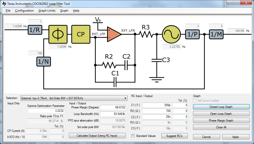

    So, I think that the problem is now solved, by setting the Smart Mux bits to Ref In.  However, I would be grateful if you could give me the ideal set of external components, based on an fPFD of 7.425MHz, and a oscillator frequency of 2227.5MHz, and specifying an R3, C3 and current combination that is in the CDCE62002.
    All the best
    Martin
  • Hi Martin,
    I am glad to hear the VCO stays locked now. Your observation actually makes sense. Here is what happened:
    The AUX input is internally AC coupled. The oscillator stage if no XTAL is connected will start to self-oscillate. Even if the external input is grounded, the AC coupling will still allow this internal oscillation. This oscillation only occured in a small temperature range. As soon as the AUX internally oscillates, the smart-mux has trouble because the oscillation frequency and the PRI-Input frequency differ by more than 10%, which is not acceptable by the spec.
    So by you selecting PRI input only, you practically disable the AUX stage, thus getting rid of the oscillation and the smartmux toggling.
    COncerning your question on the loop filter, and assuming a clean reference clock, I would use the highest possible bandwidth you can get, meaning to minimize R3 and C3. The smallest possible values are 5k and 38pF, with a I(CP)=3.75mA. This produces a 3rd pole at 837MHz. THerefore, your loop bandwidth should be equal or less than 100kHz. I recommend the following filter assuming fPFD=7.4MHz and fVCO=2.2GHz:
    C1=500pF
    R2=700
    C2=25nF
    R3=5k
    C3=38pF
    this will get you:
    BW=93k
    PM=99 degree
    gamma=3
    This should get you pretty good performance.
