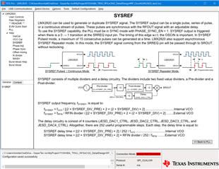

Q1: In order to output SYSREF (SROUT output) from the LMX2820,
is it necessary to change the SRREQ pin from Low to High?
In this project, SYSREF will be output in Continuous mode.
When I opened the Help for the SYSREF block in TICS Pro, I found the explanation shown below.
I am asking this question with reference to this image.
Q2: Does the LMX2820 not have a function to enable SYSREF output via SPI like the LMX1204?
