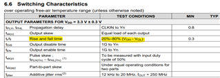

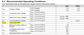

Is the slew rate stated on recommended operating condition, from 20% to 80% swing?
Because on table 6.6, the rise and fall time is measure with 20% to 80% of the swing.

Hi Kei,
Slew rate is typically 20% to 80% as well unless stated otherwise.
