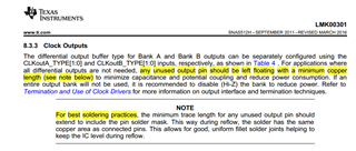

hi,
we use LMK00301 for 8 buffer outputs. two left unused. LVDS output.
can we just floating the unused output pins without any PCB trace? or can we just connect 100ohm termination resistor?
how to understand the following information in datasheet  “left floating with minimum copper length ??”? Thanks!
