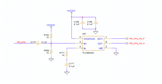

  • Hi Michael,
    I am using TLV3604DCKR, in the circuit now. Below is the circuit, input is 160MHz analog sine wave and output 160MHz differential signal.
    Can i give AC coupled input, please verify the circuit, AC coupling not mentioned in the datasheet.
    Pawan

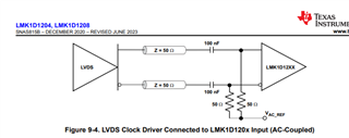

  • Hi Pawan,
    In theory yes, the LMK1D device allows for AC coupled input given we have a VAC_ref pin which can be used to set the common mode of this pins.
    This eliminates the need for having a different supply for the termination pull up to VTT.

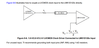

    You cannot directly AC couple the input to the device though as there is no internal bias.
    Technically you can directly input a SE signal to LMK1D and bias the unused input to VDD/2.
