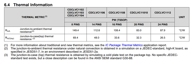

What is the recommended operating junction temperature for CDCLVC1104?
Datasheet lists an absolute maximum junction temperature and I would like to inquire if the recommended operating junction temperature is different.

    Are you assuming maximum power dissipation when operating at 85C when you state that the device operating at 85C will not reach its Junction temperature? Does and 85C ambient temperature at max power dissipation result in a 125 junction?
    The relationship between junction and ambient is Tj=Ta+Pd*ThetaJA
    Assuming Tj max is 125, Pd=(125-85)/149.4=.267W

    Can you tell me what the maximum power dissipation is or clarify what the junction temperature is at 85C at a maximum power dissipation?
    And if I understand this, so long as the device's junction is below 125C then it is okay?
