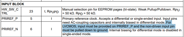

We are planning to use CDCLVC1310RHBR as the input source to CDCE6214RGET (configured for PCIe clock generation). Both devices are powered at 1.8V
Can you please confirm:
  1. Is it safe to connect CDCLVC1310RHBR output directly to CDCE6214RGET input at 1.8V?
  2. Are there any known issues or recommendations for this configuration?
Pradeepraj M
  • Pradeepraj,
    No issue that we are aware of. Please note this information from the datasheet for providing a single-ended input to the CDCE6214:
    Kadeem

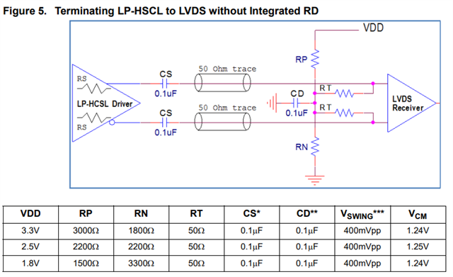

  • Hi Kadeem,
    LVDS receiver is ArtiX 7 FPGA (XC7A100T), Currently we are using AMD recommended termination for LVDS to HCSL. I attacjhed the reference below. Kindly confirm is it valid to use in design and share the document link you gave above for clock termination.
    Pradeepraj
  • Pradeepraj,
    The clock termination document that I was referring to can be found here: https://www.renesas.com/en/document/apn/891-driving-lvpecl-lvds-cml-and-sstl-logic-universal-low-power-hcsl-outputs.
    The termination is integrated, so the series 33 Ohm resistor is not necessary.
