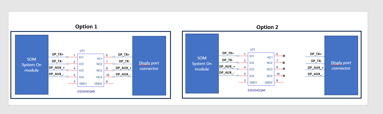

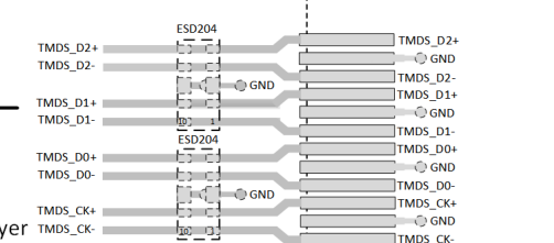

Hi Team,
We are using the below-mentioned ESD protection device for the DisplayPort 1.2 interface. There is some confusion regarding the connection of the I/O pins. Kindly confirm the correct option for connecting the differential signal pairs.
Also, please confirm whether this device is suitable for protecting differential DisplayPort signals.
