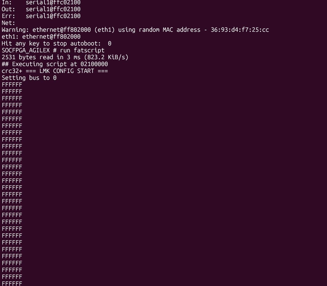

We are configuring LMK04828 from Linux and U-Boot in an Agilex + AFE8030 setup.
LMK configuration from Linux works and AFE relink succeeds.
But when configuring the same LMK registers from U-Boot using sspi,it is not locking and even returning FFFFF.
In Linux flow, we perform:
->I2C pre-sequence->CPLD unlock ->SPI mux switch to LMK ->LMK SPI writes ->SPI mux switch back to AFE
Is there any additional timing/reset/PLL lock/SYSREF sequence required when configuring LMK04828 from U-Boot?

  • Hi Kang,
    The SPI routing is:
    Based on our software flow, SPI access appears to be routed through CPLD/mux logic toward the LMK04828 on the AFE8030EVM.
    In Linux:
    • SPI device used is /dev/spidev1.0
    • LMK04828 programming succeeds
    • Both PLLs lock
    • AFE relink succeeds
    Sequence used:
    1. HPS I2C pre-sequence
    2. CPLD unlock
    3. SPI mux switched to LMK04828
    4. 136 LMK registers written over SPI
    5. SPI mux switched back to AFE8030
    In U-Boot:
    • Same I2C/CPLD/mux sequence is executed
    • Same LMK register values are sent using sspi
    • But SPI transactions return FFFFFF
    • LMK does not fully lock
    • JESD relink later fails with PLL Loss of Lock / Link Not Up errors
    From Linux logs and behavior, SPI communication to AFE8030 itself appears functional, but the LMK SPI path from U-Boot may not be matching the Linux SPI transaction format/timing.
