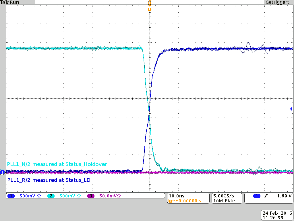

  • Dear Alan,

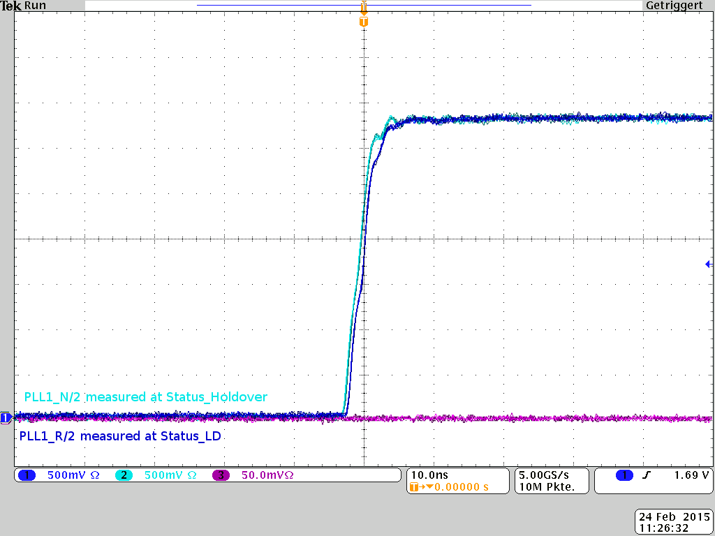

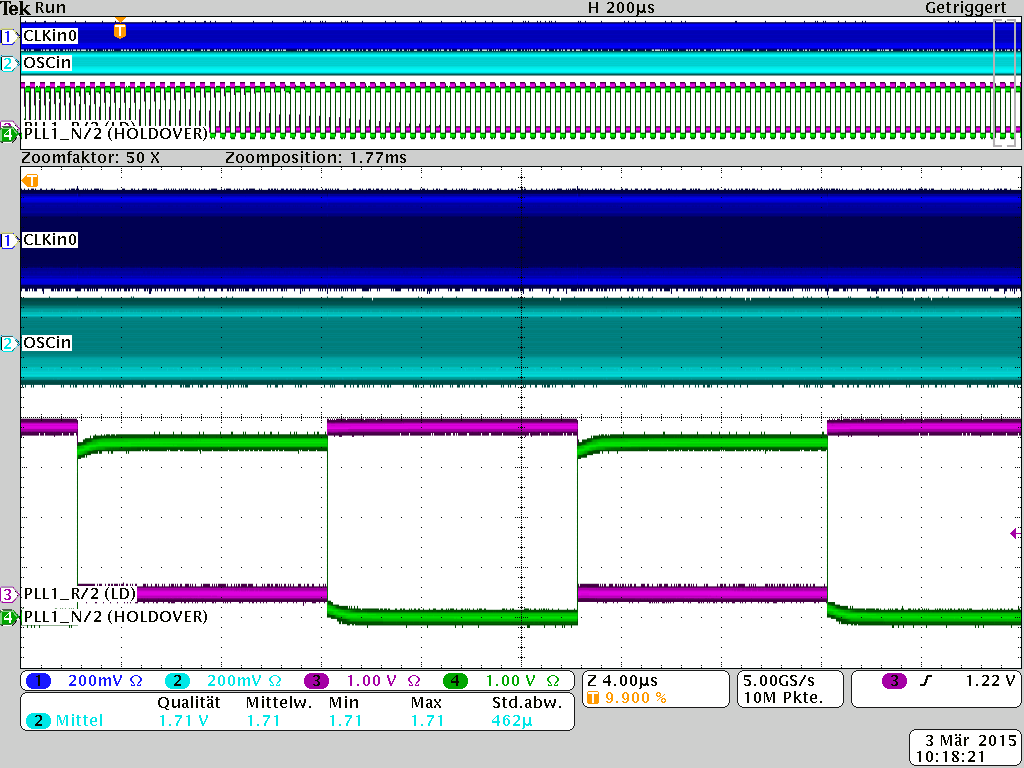

    We changed our LMK04816 programming so we can measure "PLL1 N/2" and "PLL1 R/2" on the Status_LD and Status_Holdover pins. What we see is that PLL1 N/2 and PLL1 R/2 are "edge aligned". Sometimes the rising edges of N and R are aligned, and sometimes the rising edge of N is aligned to the falling edge of R. You can see it in the following two pictures:
    I think this is because we are looking at N/2 and R/2, is this right?
    Now we reprogrammed the LMK04816 with our original settings, and probed CLKin0 and CLKout4. Since the LMK is in 0-delay mode, they should be phase aligned, too. As you can see on the next picture, they are phase aligned:
    My assumption is that the 3.5ns delay between the two clocks comes from the fact that we use internal 0-delay mode. With internal 0-delay mode, the delay of input and output buffers is not included in the loop what leads to the static phase difference we see in the picture. Do you agree?
    But the Status_LD pin, which is programmed to show us the lock of PLL1 and PLL2 stays low. And low means "no lock".
    Any further ideas?
    Niels

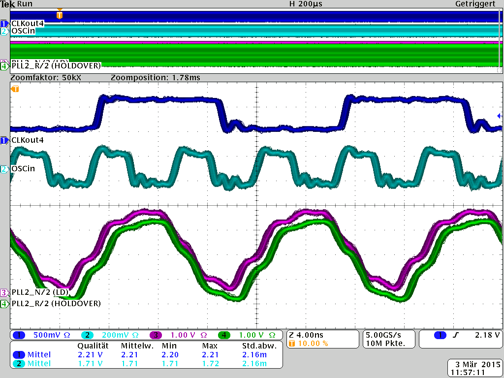

  • without an answer from TI, we did some additional tests.
    First, we removed 0-delay from our LMK04816 configuration and changed LD_Status to output PLL1_DLD only.
    In this configuration, we see PLL1 lock. But a bit of cold air is enough to let PLL1 lose its lock.
    How can we make PLL1 more stable?
    Second, we changed the function of LD_Status to output PLL2_DLD in the above configuration. But we never see a lock of PLL2.
    The external Loop-Filter of PLL2 (calculated by Clock Design Tool) is C1=47pF || C2=4.7nF + R2=470R.
    Is this ok, or do you suggest something else?
    What can prevent PLL2 from locking when PLL1 is locked and 0-delay mode is NOT used?
    Third, we set PLL2_WND_SIZE to 0x3 (reserved), and by miracle we get a lock of PLL2.
    Please explain this to me.
    I am looking forward to your answer.
    Niels

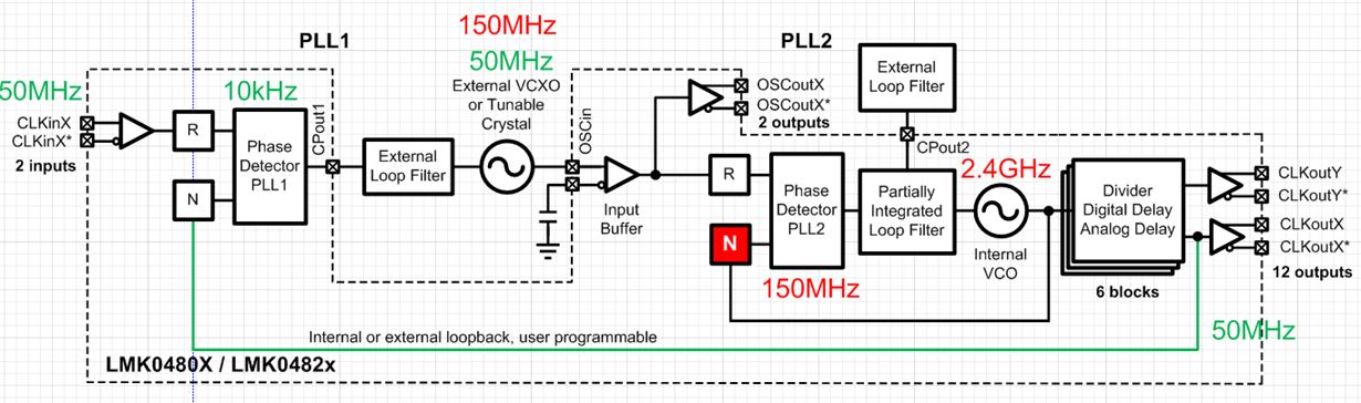

  • Hello Niels,
    let me get up to speed and look into your challenge.
    Some questions + answers from my side:
    4816 & 4806:
    Please check the detailed block diagrams in the data sheets. Main differences are the CLKin2 & OSCout1! So basically you get an additional input on the 4816 vs an additional VCXO copy output on the 4806. I need to check the details of the bitmap to see what happens when you program the setting of the other device.
    One observation from your MAC file which might explain the issue ...
    I think your PLL2_N divider might be set not deep enough.
    Please let me know if this was the issue. If not, please let me know which VCXO you have and where your CLKin input source comes from.
    Thanks!
    Patrick
  • Hello Patrick,
    PLL2_N_Pre = 2 and PLL2_N = 8
    With 2.4GHz VCO, this results in 150MHz PDF of PLL2.
    The external VCXO of PLL1 is running at 150MHz. I think that fits.

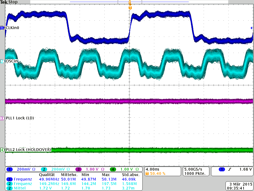

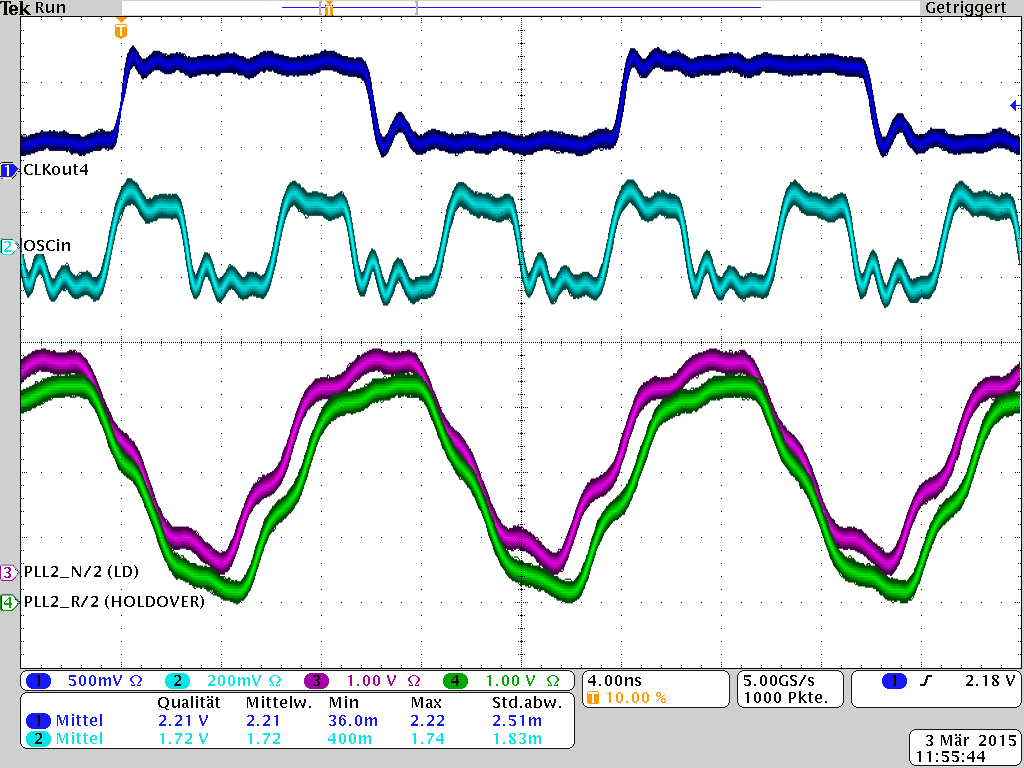

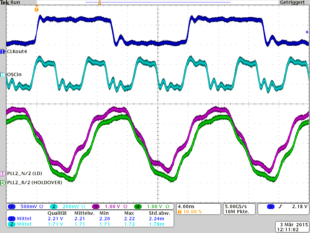

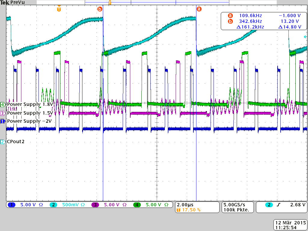

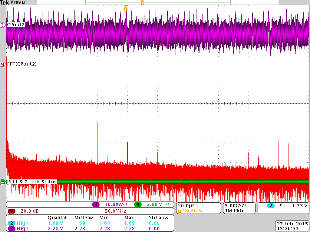

  • Hello all,
    I did some measurements of the CPout1 and CPout2 signals. For DC-level, see the scope's measurement at the bottom of the pictures.
    The first one gives you a coarse overview:
    Now I configured the scope to calculated the FFT of both CPout signals.
    CPout1:
    CPout2:
    Can you see anything that helps?
    Niels
  • Hello Niels,
    thanks for making the scope shots!
    In the first FFT scope shot from CPout1, PLL1 is unlocked, correct? (green line in the background?)
    I will post some configurations and a guideline in some minutes, so that you can check the device step by step.
    Your scope will come in handy to measure the signals from the PFDs again.
    I want to search for a capture of the point in time where the a PLL unlocks. Therefore you will need to do a skew/ setup/hold measurement and create a track waveform.
    Patrick
  • Hello Patrick,
    yes, the combined PLL1 & 2 Lock Status is 0 (unlocked) in all three pictures.
    Niels

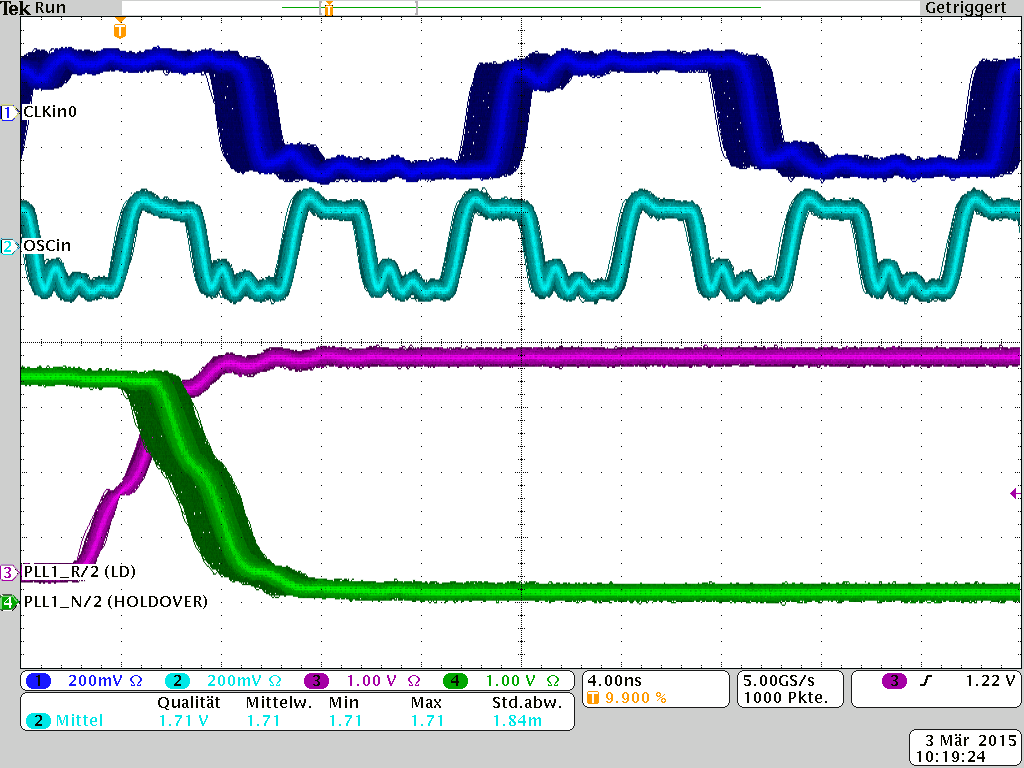

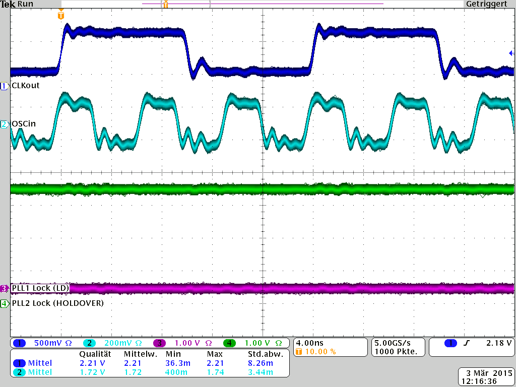

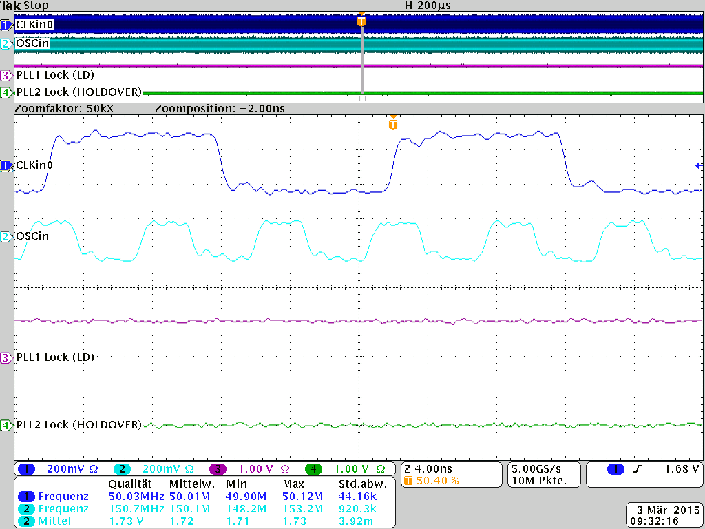

  • Hello Niels,
    thanks for the confirmation of the lock status in the captures!
    I created test configurations for you (renamed codeloader .mac files).
    1. Dual Loop Setup to test the first PLL.
      1. Load the registers from the "LMK04806_DualLoopintVCO_PLL1_PFD_100k" using the recommended sequence
      2. pull RESET in R0; then reprogram R0 with actual values, then continue in order R0..R31.
      3. PLL1 lock detect is on STATUS_LD, PLL2 lock detect is on HOLDOVER_MUX

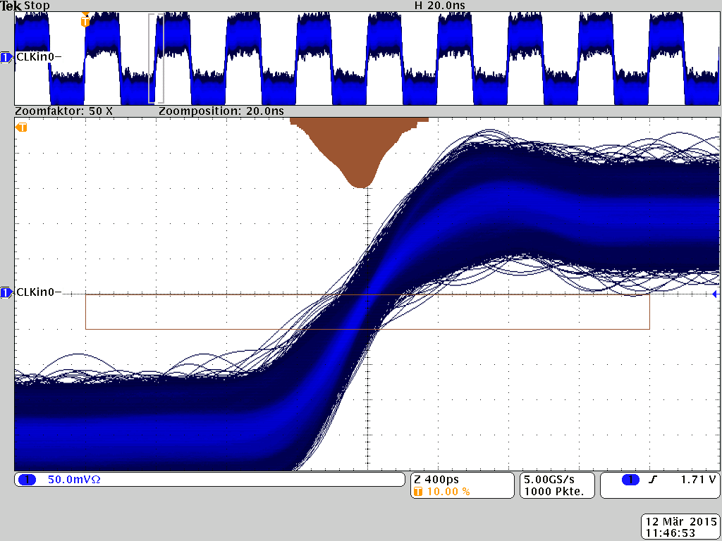

    2. Please observe the following signals:
      1. CLKin0
      2. OSCin
      3. PLL1 lock on STATUS_LD
      4. PLL2 lock on HOLDOVER_MUX
    3. Please check if the device indicates lock or not.
      1. Use a longer capture time and use a "track waveform" to see how the phase of the input and output moves (and have the indicated lock status in the capture).
      2. Please observe, like you did before, in persistence mode, so we can see any jumps of the input or output.
    4. Change Status signals
      1. PLL1_R/2 is on STATUS_LD, PLL1_N/2 is on HOLDOVER_MUX
      2. For crosscheck I created a mac "LMK04806_DualLoopintVCO_PLL1_PFD_100k_check" as reference.
    5. Please observe the following signals:
      1. CLKin0
      2. OSCin
      3. PLL1_R/2 on STATUS_LD
      4. PLL1_N/2 on HOLDOVER_MUX
      5. Try to capture a similar shot like before. The goal is to understand if the PLL actually unlocks or if the indicator setting does not match to the settings.
    6. Please also let me know if there are any vibrations in your application which could influence the (packaged) VCXO.

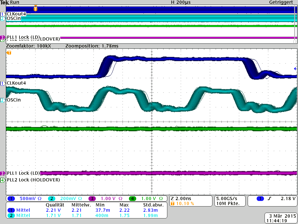

    7. Single Loop Setup to test the second PLL.
      1. Load the registers from the "LMK04806_SingleLoopintVCO_PLL2_PFD_150M" using the recommended sequence
      3.  PLL2 lock detect is on HOLDOVER_MUX (still: PLL1 lock detect is on STATUS_LD)
    8. Please observe the following signals:
      1. OSCin
      2. CLKout0 or CLKout4
      3. PLL2 lock on HOLDOVER_MUX
      4. Try to capture a similar shot like before. The goal is to understand if the PLL actually unlocks or if the indicator setting does not match to the settings.

    10. Change Status signals
      1. PLL2_R/2 is on STATUS_LD, PLL2_N/2 is on HOLDOVER_MUX
    11. Please observe the following signals:
      1. OSCin
    Patrick

  • Patrick and Alan,
    the board resides on my table in the lab, no shock or vibration at all.
    I programmed the LMK04806 with your "LMK04806_DualLoopintVCO_PLL1_PFD_100k" register-set, and got the following pictures (PLL1 is locked, CH3 had a DC-offset programmed in the scope) :
    Now I removed the lousy DC-offset of CH3 and programmed the "LMK04806_DualLoopintVCO_PLL1_PFD_100k_check" settings:
    With the "LMK04806_SingleLoopintVCO_PLL2_PFD_150M" settings programmed into the LMK04806:
    "LMK04806_SingleLoopintVCO_PLL2_PFD_150M_check" settings:
    And now, the pics from the "LMK04806_SingleLoopintVCO_PLL2_PFD_150M_check_holdover" setting:
    I hope this is helpful. If you need any other measurements, please tell me.
    Niels
  • Hello Niels,
    thanks for sharing all the measurement data! This is very helpful. It is good to see we can get the individual loops working. Let me do some more thinking and I'll try to get you back on your original configuration (or similar).
    Patrick

    I also observed, that the CPout2 "frequency" varies, when I slightly move the probe at CPout2 without interrupting the contact between probe and signal. You can see it in the following video (sorry for the crazy orientation, I missed to pay my gravity-bill):
    King Regards,
    Niels
  • Hello Niels,
    sorry for the delay in reply.
    The first screenshot with the triangular signal on the CPOUT2 hopefully comes from noise injected through the probes. I assume the CLKin to CLKout4 is not locked?
    Patrick
  • Patrick,
    I'm sorry, but I don't think that the triangular waveform is noise. It's the same signal as the yellow one in the Video.
    Form my point oft view, it's PLL2 that tries to achieve a lock.
    How do you explain that moving the Probe without interrupting the contact between Probe and signal changes the triangular frequency?
    I will do more measurements tomorrow to check lock between clkin and clkout.
    Niels
  • Hi Niels,
    Since Patrick had stepped in to help you debug, I lost track of the issue somewhat. Here are some comments based on the situation as I understand it (my apologies if I missed something).
    When you measured the triangular-shaped waveform on CPOUT2, was the probe's ground lead connected? From the video, the ground lead appears to be disconnected. Perhaps that's why you see that triangular waveform instead of a steady voltage. I assume the probe is high impedance (Mohm?) to avoid charge leakage. The period of the triangular waveform appears close to 250 kHz; is there a switching regulator nearby?
    Can you confirm if the output frequency is locked to the input frequency when you observe the these signals on the scope? If so, then it may not be an actual PLL lock problem but rather a Lock detection/indication issue. Lock detection issues can be related to static phase offset at the PLL's PFD inputs due to charge leakage on the VCXO/VCO Vctrl inputs (check for leaky loop filter caps, flux residue from loop filter rework, or probe loading) , or dynamic phase offsets or tracking skew (check for excessive high input clock jitter or other sources of VCXO phase drift/modulation like temperature, microphonics on MLCC loop filter caps or VCXO). If the combined static + dynamic phase offsets exceed the DLD lock detector window, then it's possible that the DLD will not indicate lock even though the PLL is actually locked and stable.
    Can you determine if PLL1 or PLL2's DLD signal is causing the combined "PLL1 & PLL2 DLD" signal to be low? Try looking at Status_LD output with LD_MUX = "PLL1 DLD" (R12[31:27] = d'1) and then "PLL2 DLD" (R12[31:27] = d'2) to determine which PLL or if both PLL's lock status is causing the Status_LD output to be low.
    Usually I see more cases where PLL1 DLD signal is causing the lock status issue.
    If PLL1 DLD status is Low, I suggest you try the following and check if PLL1 DLD indicates lock?
    1. Increase PLL1_WND_SIZE to "40 ns" DLD window (R24[7:6]) = b'11).
    2. Increase PLL1_CP_GAIN to "400 uA" (R27[27:26] = b'10) to increase PLL bandwidth.
    3. Check loop filter for leaky caps, flux residue, or probe loading that could introduce excessive charge leakage and static phase offset.
    4. Check if input clock cycle-cycle jitter is larger than the programmed lock window, or other potential causes for dynamic phase offset as mentioned above.
    By the way, are you powering the LMK device with a LDO regulator or DC/DC?
    Alan
  • Hi Alan and Patrick,
    welcome back to this nasty little problem, Alan. I will now try to answer all your questions:
    - The probe-ground is connected to the (grounded) metal plate above the LMK04806 by a solid wire. In the video, it's hidden by the probe itself.
    - The probe is an active voltage probe with 1M Ohm and <1pF
    - You are right, there are three switching regulators nearby. I made a scope shot of CPout2 and the switching nodes of all three switchers. IMHO, there is no relationship between them. What do you think about it?
    - As you can see in the next scope shot, the output frequency (CLKout4) is not locked to the input frequency (CLKin0):
    We tried PLL1_DLD and PLL2_DLD on Status_LD, and both are "low" (no lock).
    - Please see the following picture for cycle-cycle jitter of CLKin0 (the brown thing is a histogram with log. y-axis scale):
    - Yes, the LMK is powered by a switching regulator. The following picture shows the measured power-supply noise prior to the LMK power-supply-filters (+-10mVpp):
    I use the good old handheld multimeter and measured the resistance between both CPout and ground:
    CPout1: 2.3M Ohm
    CPout2: 2.5M Ohm
    Is this ok, or does this lead to excessive charge pump leakage?
    This was all done with Patricks last register-set.
    Niels
