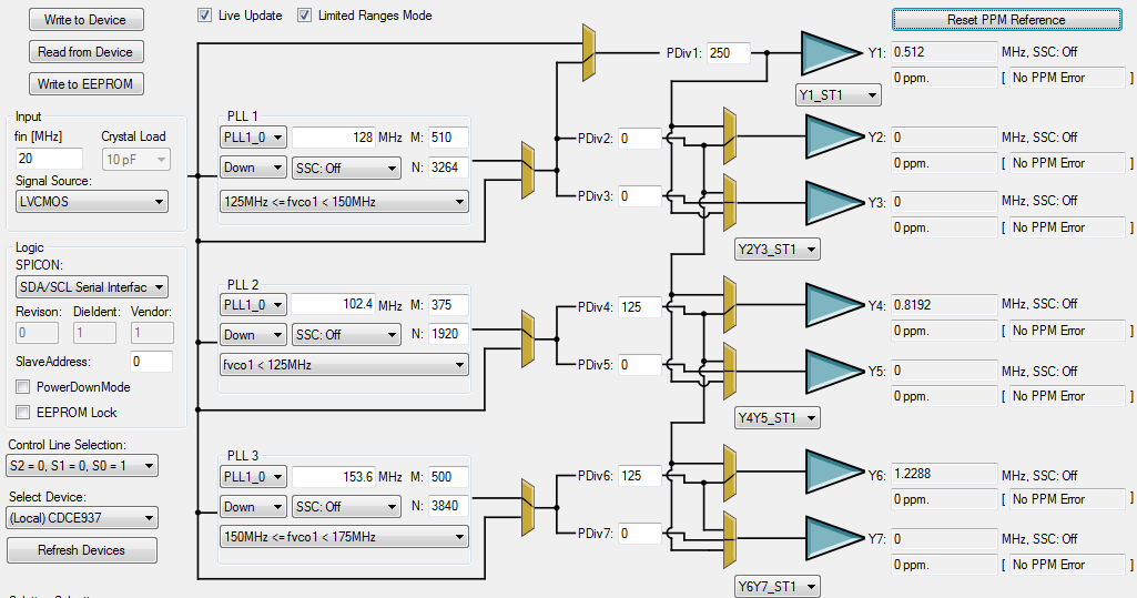

Hi E2E! I Need some help with the Synthesizer CDCE913. My input frequency is 20MHz and i´d like to setup the I2C Registers for the Output Y1 -> for the Output-Frequency 409,6kHz, 512kHz and 614,4kHz!

Hi Arvind,
that´s right!, I´d like to configure the CDCE913 with a single frequency on Y1! Each frequency should be possible to adjust in the CDCE (409.6kHz, 512kHz and 614.4kHz)!

Hi Thomas,
See individual configurations with CDCE913
In order to get a solution with the ClockPro tool Wizard, enter a frequency (> 1 MHz) that is a multiple of the required kHz frequency. You could modify the PDiv1 divider to get the required frequencies once the tool recommends a solution and you are able to get into the setup details.
