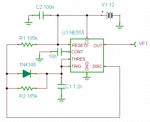

Is there correction point of attached circuit, please let me know.
【Ploblem】
・Customer made attached circuit and external value.
・They hope that clock output is "Duty:40%, 4kHz", but result was "Duty:70%~, 6kHz".
・Is Ra:Open mistake?       or is circuit have the other problem?
