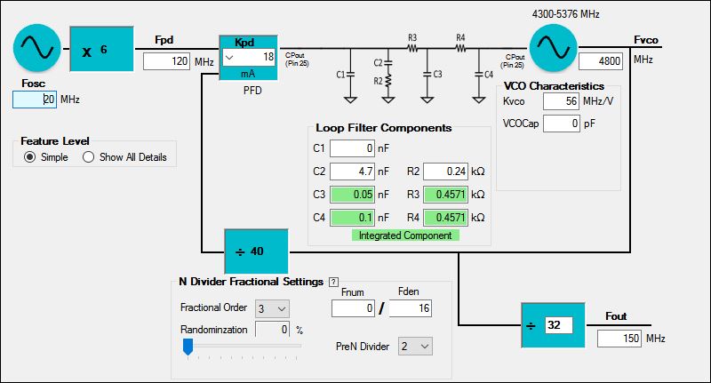

    Would you provide screen shots of your configuration?
  • Hi Noel,

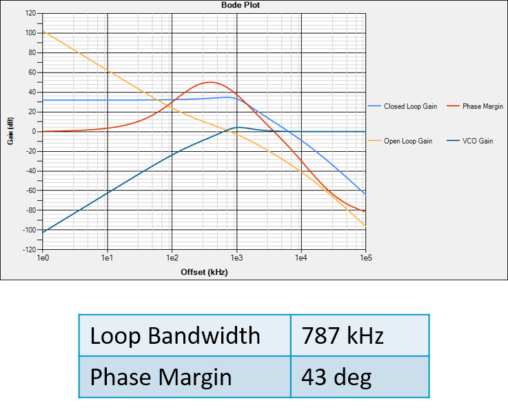

    Sure. I have put it below. I also put the loop filter characteristics of the custom board.
    As I said before, I have also tried the same setup with evaluation board with its own loop filter circuit given in the datasheet. I used different charge pump current values and nothing changed.

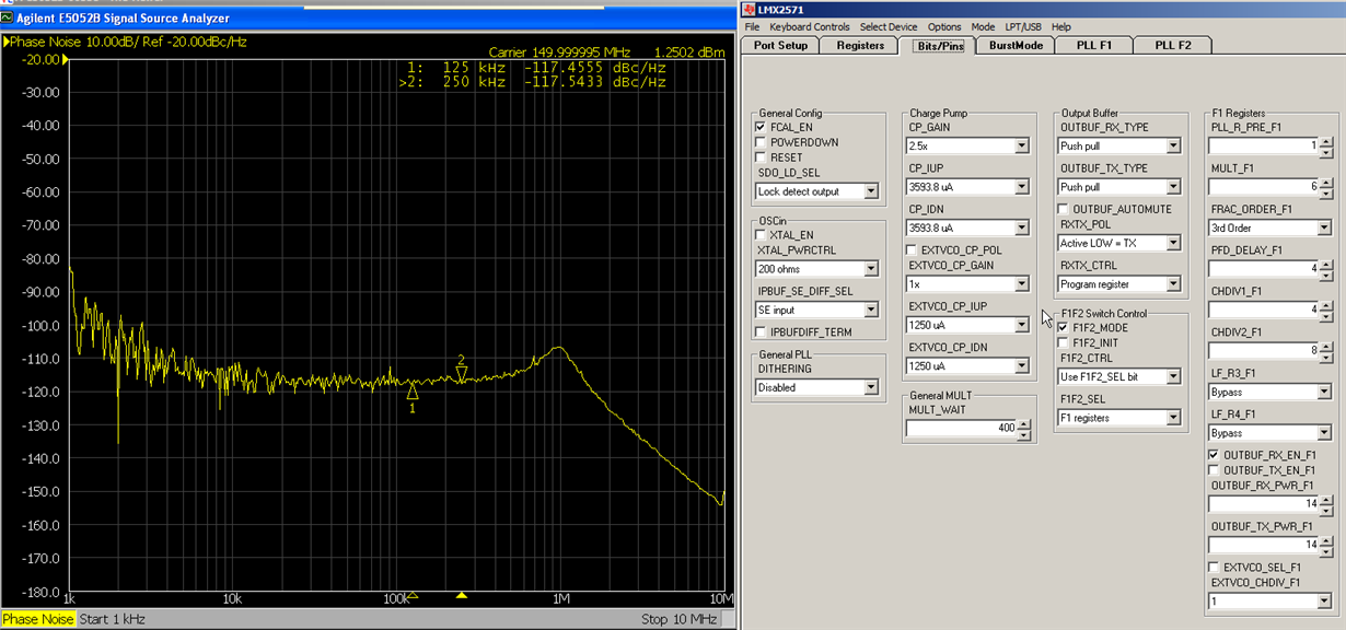

  • Hi Ufukt,
    Please check if you have setup properly on the "Bits/pins" tab. I can make it lock without changing the loop filter except R3, R4 have to be configured to Bypass.

    Thank you for the reply. I have worked on this today and I realized some different things on LMX2571. With your setting, I could also make it lock by using evaluation board with code loader. And then I tried this with microcontroller and everything was fine. But when I tried different frequency like 140MHz. It failed and did not work. Once I was trying to make it lock. I have figured out that if PLL is locked with some setting ( say for example with MULT = 4 ) you can make it lock with MULT = 6 succesfully after locked with MULT = 4. I had tested my operating freqeuncy band with MULT = 4 and it had worked succesfully for all channels. Hence I changed my code in microcontroller so it first locks with the setting MULT = 4 and then it sets MULT = 6 and locks in the desired channel. This is interesting but it worked in my application. Still I am wondering why is that so and can it be better solution for my application?
