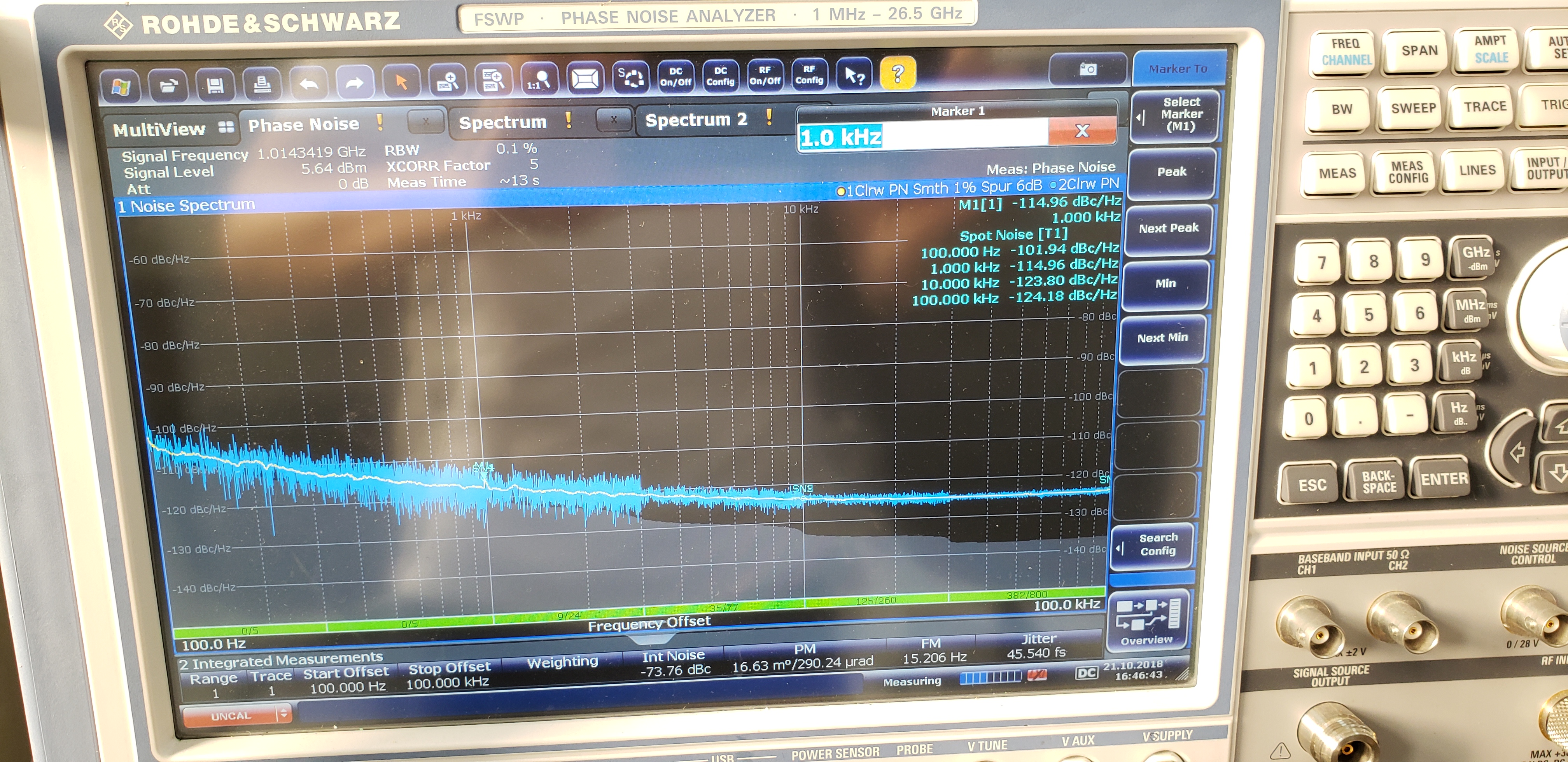

Dear TI experts,
    Refer to LMX2594/95 application note draft -Fast frequency switching using the "full assist" mode" to configure the LMX2594, register write data "0X002514", turn off the VCO Calibration function, select the VCO Calibration and VTUNE lock detect function output on the MUXOUT pin. Output 3 frequency points: 1014.344MHz, 1071.844MHz and 1297.874MHz. With the spectrum and signal analyzer test results, the frequency and phase noise are normal.
      Problem: 1. Why MUXOUT output is always low, which means that the output signal is not locked, but the signal analyzer detects that the signal is locked;
                    2. The FCAL_EN of R0 is set to 1. When the signal is locked, MUXOUT can output a high level.
