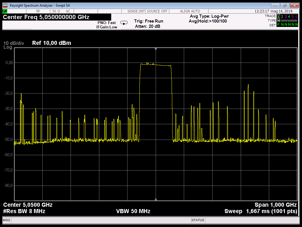

We are using your evaluation board of synthesizer LMX2572EVM. I use the 100 MHz
reference oscillator. I am making a sweep frequency from 5.0 GHz to 5.1 GHz with
51 step frequency points at the maximum possible speed waiting for the device to
lock.

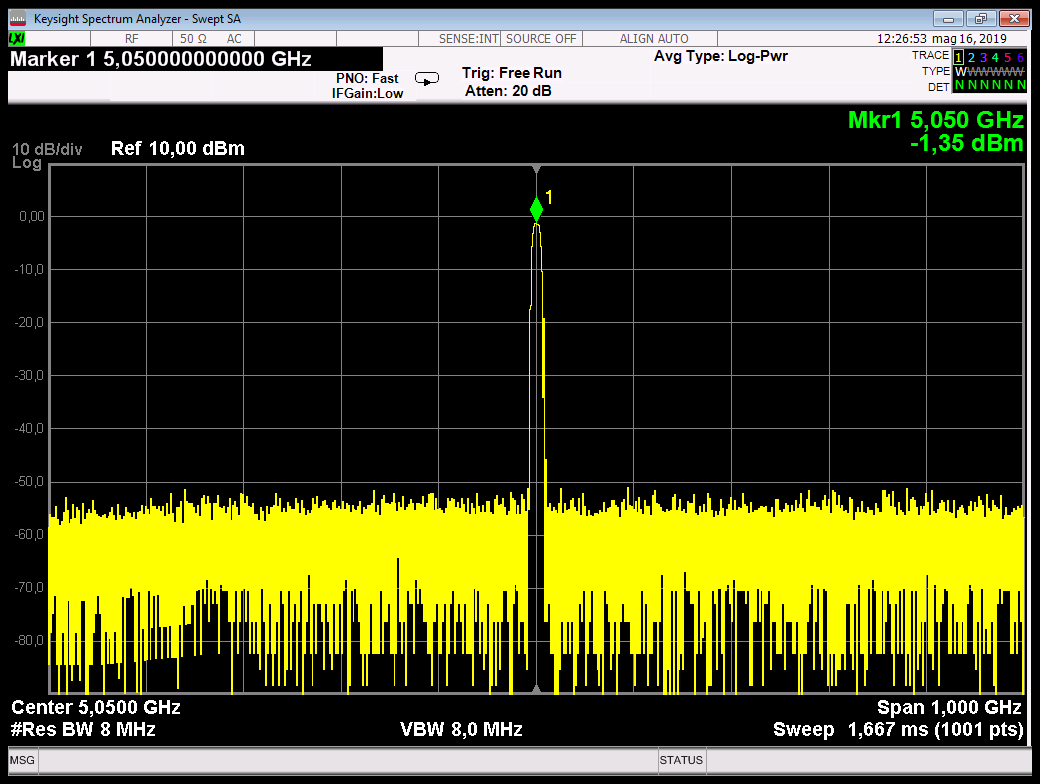

I initialized the device with the default registers for the VCO frequency of
5.050 GHz this is the output:
Is good output.

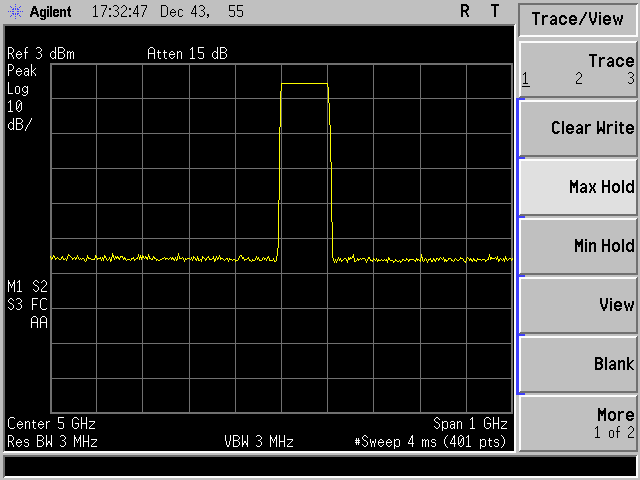

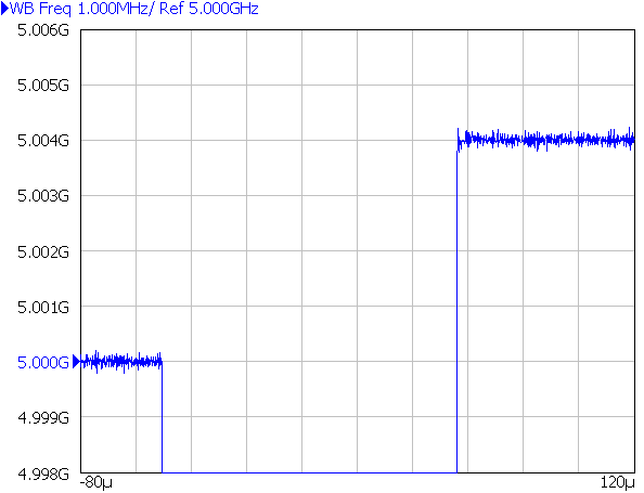

Now I want to implement a frequency sweep from 5.0 GHz to 5.1 GHz.
The device locks for all 51 frequencies without any problem, using the following
table of pre-calculated values with sequence :

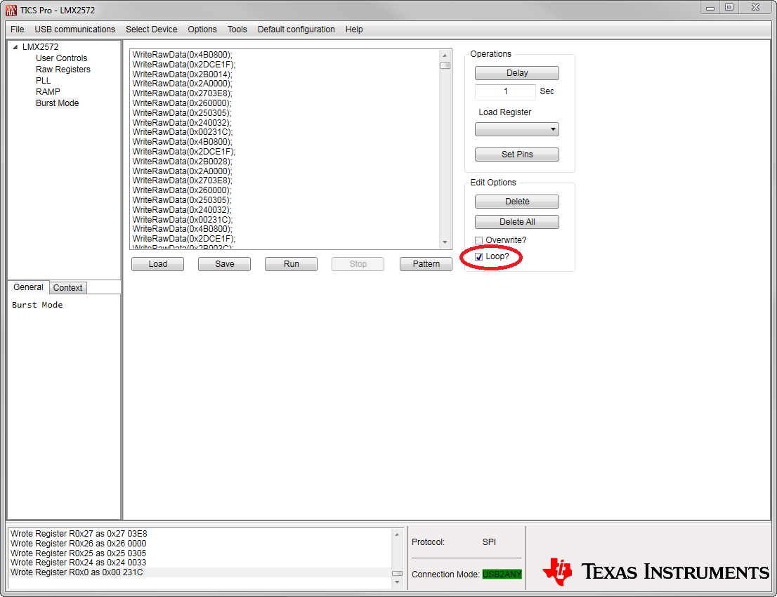

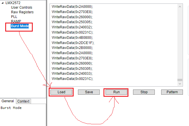

I wrote a small program that sends these frequency points continuously to create
a frequency sweep.
Flow logic:
Init_LMX2572
for(index = 0; index < 51; index++)
    Send R75/R45/R43/R42/R39/R38/R37/R36
    Start AutoCal wiht send R0
    Waiting Lock
    Continue Next Point

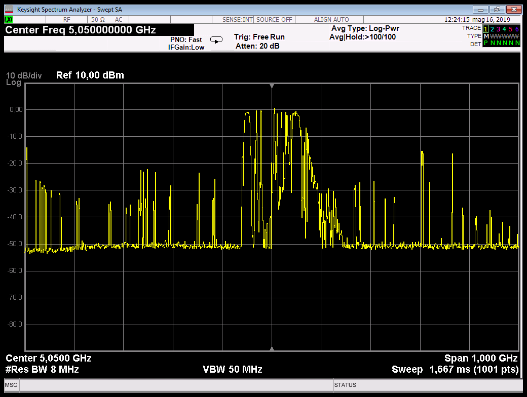

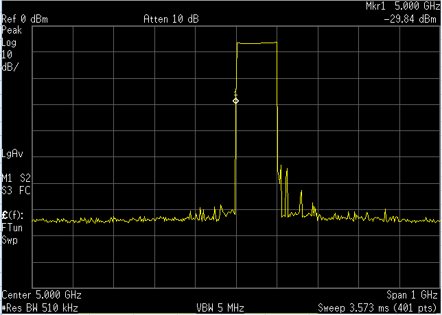

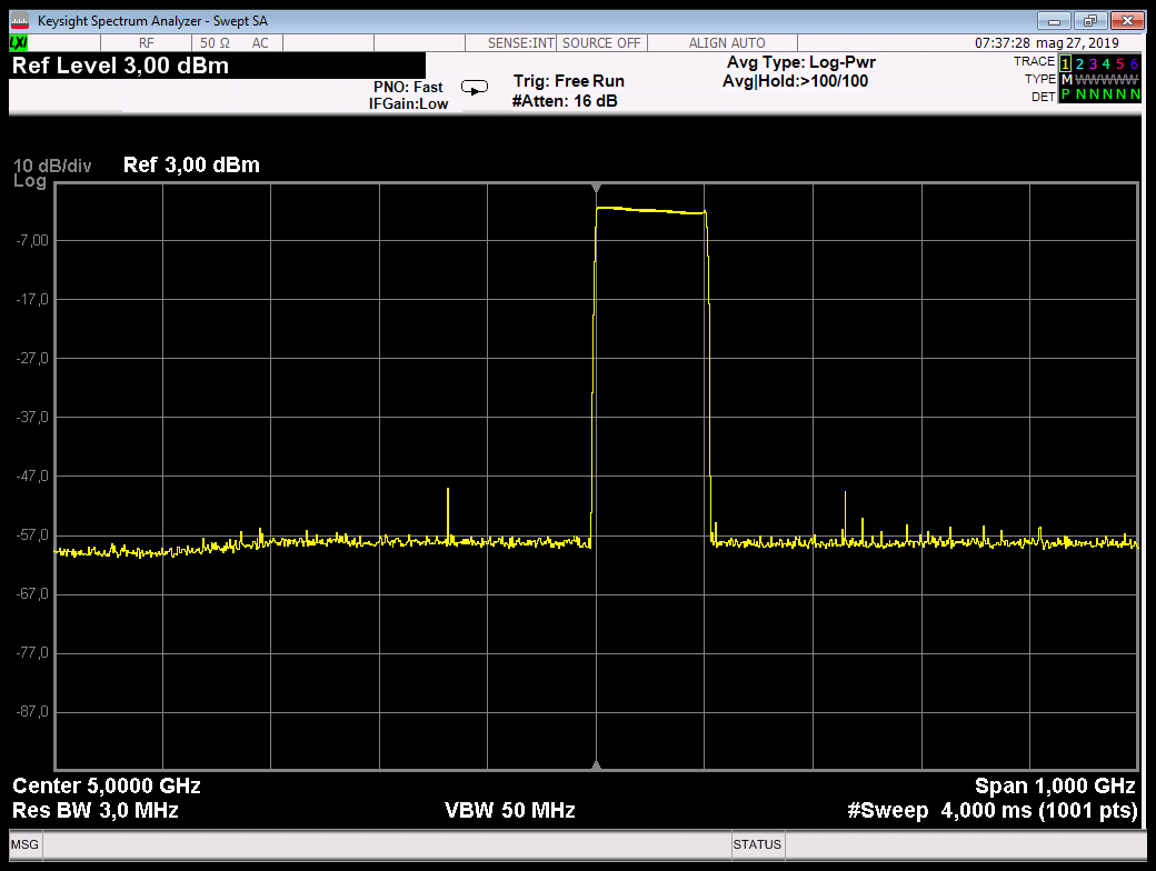

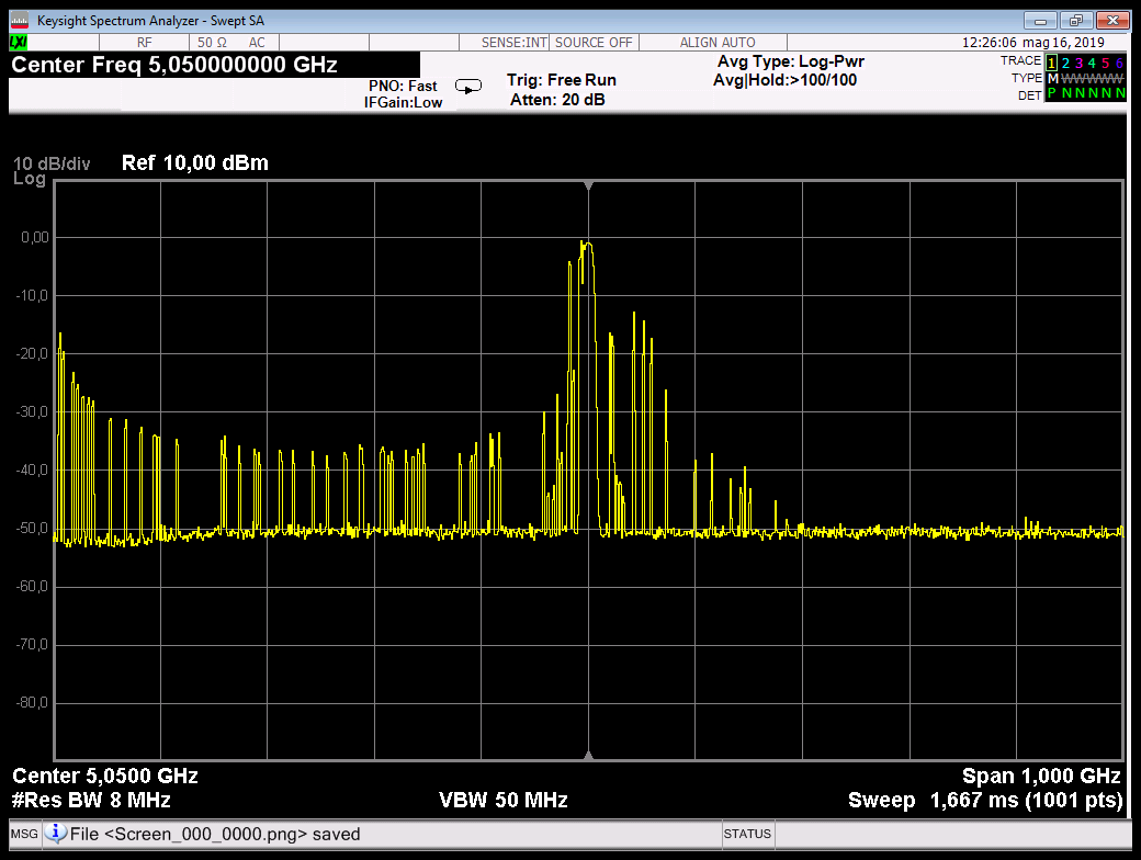

At the change of a frequency, none in particular, on the spectrum analyzer I see
spurs frequency that I think should not be there. These spurs do not seem to have
any relation to the frequency I am setting.
I activated :
 - R0  "OUT_MUTE" Mutes RF outputs (RFoutA and RFoutB) when the VCO is calibrating
 - R78 "QUICK_RECAL_EN" This sets the initial VCO starting calibration values.
   Especially useful if the frequency change is smaller, say < 50 MHz or so.
Default value:

With frequency sweep I see this:
With frequency hop I see this:
With update CW frequency continuously I see this:
Even making a very slow frequency change (example every second) the spurs are
presented in the same way.
The problem of what could be derived ?
Thanks very much.

    I did the same scan from 5GHz to 5.1GHz in 2MHz/step. My SPI rate is only 125kHz, I can't make it faster. I have the same default configuration as yours and I send the same 9 registers for each frequency step. Here is my result, I don't see any spurs during the sweep. I verified this with another spectrum analyzer and the result is same.
    your result is what I want to achieve. My SPI is clocked 9 MHz, I can try with 125 KHz.

    Yes, I used the same configuration as yours and I sent the 9 registers in each step.
    Since you have an EVM, you can try my setup.
    - Open TICS. Select LMX2572.
    - Load the attached file.
    2572.tcs
    - The VCO frequency is 5000MHz.
    - Go to the Burst Mode page.
    - Load the attached burst mode file.
    https://e2e.ti.com/cfs-file/__key/communityserver-discussions-components-files/48/sweep.tcb
    - Click Run. The VCO will be sweeping from 5000MHz to 5100MHz in 2MHz/step.
    I have follow your previous post but the spur remain. After first "Run" I obtain this:
    I set the same configuration of the your instrument, with "Res BW", "Points" and "Sweep Time" but the result is this:
    Can you try with "Res BW" of 1 MHz or less ?
    Can you reduce the noise floor or use a more performing instrument ?
    Can you also check "Loop" and then "Run" with Max Hold on the instrument ?
    Thanks very much.
    I tried Loop and 1MHz Res BW, I got the same result as before.
    I don't have a more advanced spectrum analyzer.
    I will try to see if I can use another test method to capture the spurs.
    thanks for your test. I hope you can recreate the problem.
    Thank you for your time.
  • I await your trials, thanks for your time.
  • Hi Gabriele,
    I tried Noel's configs with smaller res BW and lower noise floor. I also checked the "loop?" and waited for more than 3 minutes. I see a couple of spikes but not as bad as what you were showing. Vertical scale is 10dB/div
    Hao

  • Hi all,
    I did a precise timing programming and captured the following plot when switching frequency from 5GHz to 5004MHz. OUT_MUTE is turned on. I sent 9 registers to switch the frequency.
    Before calibration starts, the VCO frequency has already changed.
    In addition, there seems to be a glitch when the output mute being.
    I believe these two factors create the spurs at random frequencies.
    Unfortunately, there is no way to advance the mute time.
    In the following, I power down the output buffer before calibration and then power up the buffer again.
    The programming sequence is:
    R43 (change the fractional NUM value)
    R44 (power down output buffer)
    R0 (initiate vco calibration)
    R44 (power up output buffer)
    The output looks clean now.
