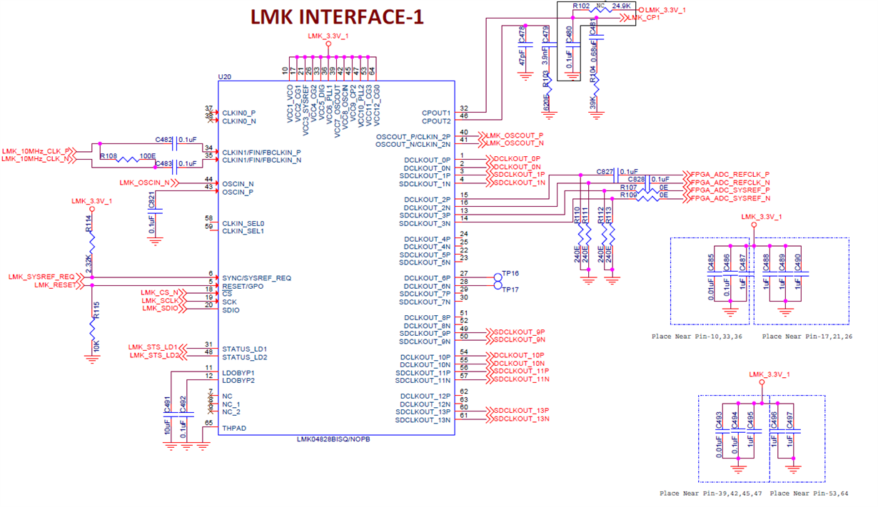

I have used lmk04828b in our design on custom board, provided 100 mhz clock to OSC pin. I have already lmk evm kit. Lmk in our custom board not working when initiated through tics pro through the cable given part of kit. I have checked reset on board it is pulled low through 10k.
OSC clock we provided is coming out of OSC out of lmk, so clock input to lmk seems ok.
We try to program the devices through 3 wire SPI, no clock is coming out of dclk/sdlk.
At this point of time, I do not know what to check.
We did not bring the clk sel pins, it is kept open.
At cp out we are measuring 1.8 V.
Biasing to the chip and controls from tics pro seems ok, when we probed.
Pls help.
Rajesh khanna.

    Could your outputs be held in SYNC?  This is programming dependent but can also be a function of pin 6, SYNC/SYSREF_REQ.  My understanding is on POR default this should be low to allow outputs.
    At POR you should also see ~315 MHz LVDS signals on CLKout4/6/8/10.  -- Do you see this?  SYNC pin as above could turn these outputs off.
    Have you tested more than one of your boards?
    When you say controls from TICS Pro seem ok, you are probing the SCK, SDIO, and CS* and confirm the clock, data, and chip select as expected?
    To confirm programming independent of clock output, can you either toggle POWERDOWN and check for change in current draw to the device or...
    - Power down --> Reg 0x002 = 0x01
    - Powered up --> Reg 0x002 = 0x00
    or program PLL1_LD_TYPE between low and high (results in Status_LD1 pin changing state low/high).
    - Low --> Reg 0x15F = 0x03
    - High --> Reg 0x15F = 0x04

  • Hi Timothy,
    Thanks for your input, i think we can rule out chip is bad.
    #1
    Initially we have pulled the SYNC to high through resistor, now we have removed it.
    As per your suggestion, we are getting around 319-315 MHz LVDS signals at  CLKout4/6/8/10.
    #2
    We have initially assembled only one board.
    #3
    we will try the 3rd suggestion to check the programming side and come back to you.
    here by attaching schematics for your reference.CS, SDIO & SCLK having 100E resistor series connected from FPGA.

  • HI,
    We found the CS line to have more noise. trying to provide a pullup and decap to see whether it can solve the problem.
    Please find the lmk sch. Another board will be assembled in a week time.
  • Ok, keep me posted on your progress.  If you are able, please also attach a scope plot of a register programming with the SCLK, SDIO, and CS* lines.
    73,
    Timothy
    Thanks for your help. After addressing CS line. We are able to get the device working.
