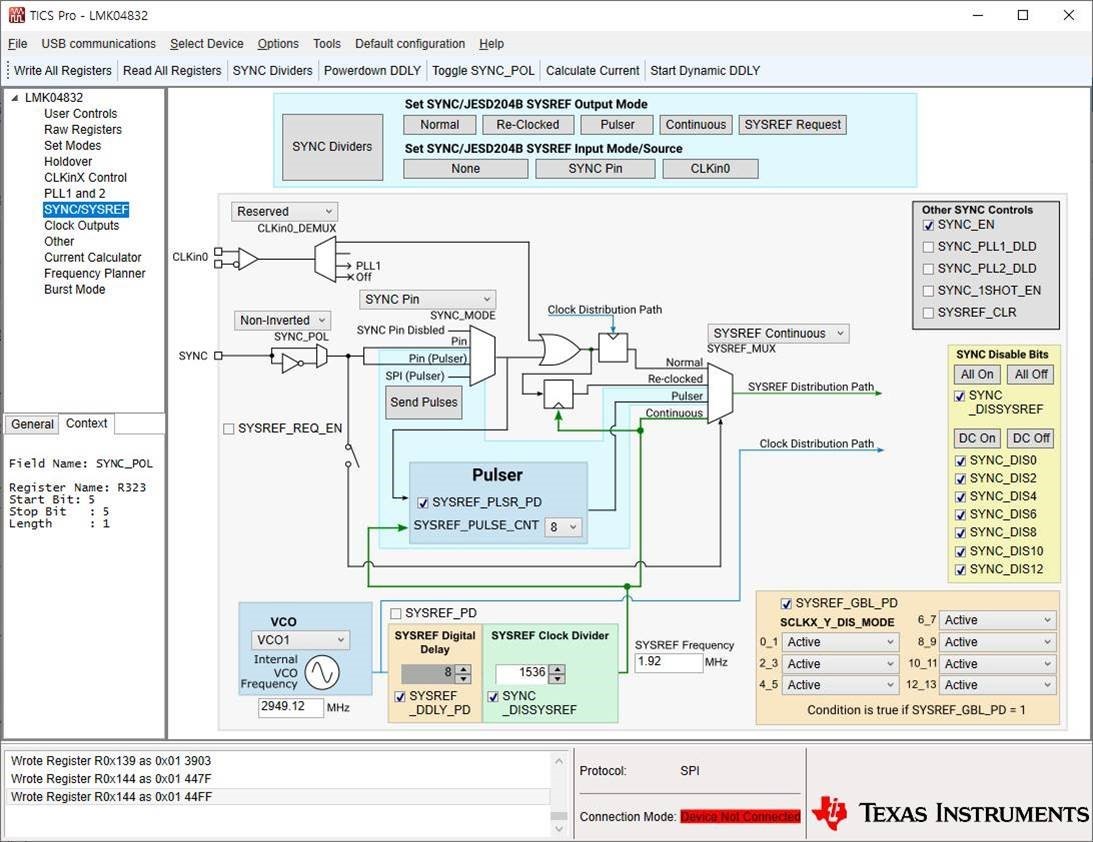

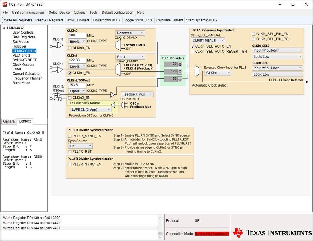

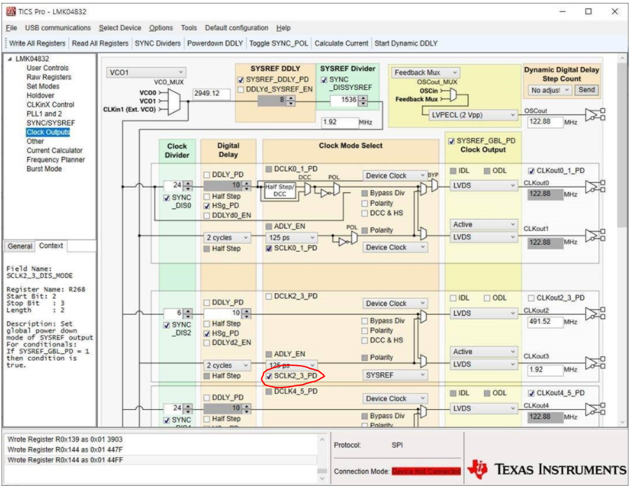

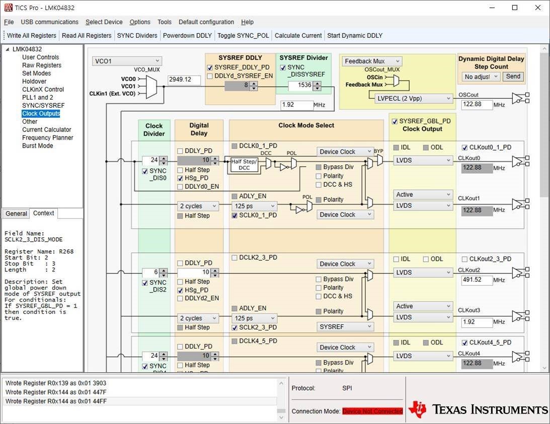

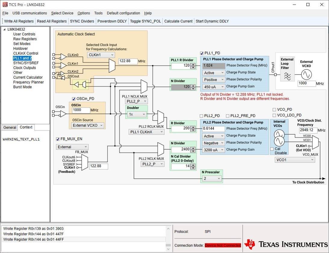

My customer would like to make 491.52MHz and 1.92MHz(SYSREF) using the LMK04832.
They set up the TISC Pro as below.
There is no 1.92MHz(SYSREF) output at CLKout3.
Please advise what is wrong.
Thank you.
JH
