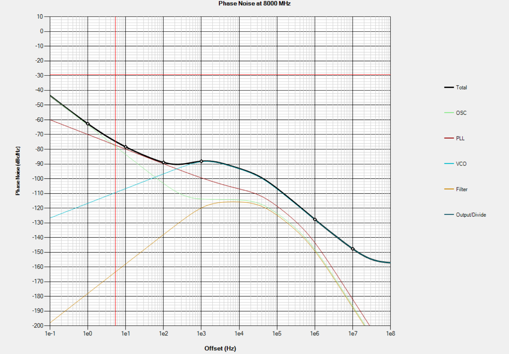

  • Hi Noel,
    I have forwarded your response to the customer and here is feedback.
    Sorry I should have included the design frequency (8 GHz). In the interest of conveying the full details, I have attached my PLLatinum design file so you can more clearly follow the characteristic I am inquiring about. My question is regarding the various phase noise contributions reported in the left/bottom panel plot window, more specifically the OSC and PLL contributions. I believe I have correctly modelled the -135 dBc @ 10 Hz phase noise of my 10 MHz oscillator. Hopefully you can see from my design file (and associated plot also attached here) that the phase noise of my 10 MHz oscillator is not the dominant phase noise source at 10 Hz as I was expecting. Rather, the 10 Hz phase noise is dominated by the PLL noise contribution and it is this component I am trying to better understand. I was hoping to see that the phase noise at offsets < 100 Hz would be dominated by my oscillator so I'm wondering what level of control there is over the PLL component. Can you offer some insight?
    https://e2e.ti.com/cfs-file/__key/communityserver-discussions-components-files/48/8GHzsim.sim
    Danilo
  • Hi Danilo,
    The phase noise at 10Hz offset is actually dominated by the reference clock. The customer is seeing the opposite because they use "Metric" to model the reference clock.
    In below is the simulation comparison using "Metric" and "Load file". I created a text file for the phase noise of the reference clock. This method returns the best accurate simulation.
    Below 10kHz offset, the phase noise of LMX2594 is dominated by the 1/f noise of the PLL. This noise is determined by the process and design, and is not software configurable.
