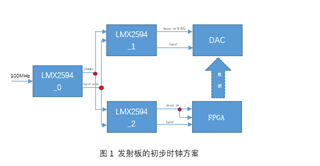

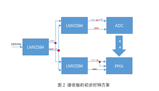

At present, the possible clock scheme is to use three lmx2594 chips to realize the system. This scheme is officially given by Ti (the information name is "phase synchronization reference design of multiple PLL synthesizers", which I have published in the group). In the reference design, the clock input and sysref synchronization pulse of two lmx2594 chips in the second stage are required to be provided for the same clock chip, so as to realize the system The input and output clocks of two lmx2594 chips have deterministic phase. For this kind of application, it is officially recommended to use lmx2594evm or lmk04828evm to provide this clock and sysref, but the phase noise deteriorates seriously when lmk04828 generates prime frequency, so lmx2594evm can be selected as the first stage clock chip, as shown in Figure 1 and Figure 2.
For our application, if lmx2594 works in Category3 mode, that is, there is no integer multiple relationship between lmx2594 input 100MHz and output, then lmx2594_ 1/ LMX2594_ 2 requires lmx2594_ 0 provides strict clock and synchronization signal, which is used to determine the phase relationship between the input and output of the second stage lmx2594, lmx2594_ 0 provides the clock and synchronization signal and needs phase alignment.

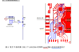

At present, the crux of the problem lies in whether the position of the red dot in Figure 1 and Figure 2 is allocated by direct work sharing or by using the clock buffer with fixed delay. The official evaluation board uses direct power sharing method to evaluate lmx2594 at the two red dots on the left_ The output clock of 0 and sysref are allocated, and the synchronization is achieved by controlling the line length, as shown in Figure 3. If buffer is used, the jitter introduced by buffer should be less than 1ps (many are about 100fs). At present, which method we use needs to be further determined. It's better to find ti's engineers to determine. At present, can we design redundancy through buffer or power sharing? It is better to set test points for each node of the clock link to facilitate subsequent testing.
  • Hello Zhang Ping,
    For demonstration purposes on the dual PLL board, the OSCin input and SYNC/SYSREF input were connected through a power splitter with little attention given to signal integrity. At 100MHz with short traces, it was determined that the signal integrity would not be impacted enough to affect the evaluation module results, since the evaluation module was designed to showcase the relative phase alignment capability of multi-device synchronization and not the phase noise performance.
    We recommend using a clock buffer with fixed delay for the OSCin input, for several reasons: preserving differential signaling reduces common-mode noise and improves overall phase noise performance; the skew between outputs on the same buffer can be minimized by design; and the additive jitter at typical OSCin frequencies for the LMX2594 (<200MHz) is not very high inside the PLL loop bandwidth. Outside the PLL loop bandwidth, the loop filter will attenuate the reference contribution to the output noise, so noise floor performance is not critical to the buffer capability.
    For the SYNC/SYSREF input, the only critical requirement is that the edge rises monotonically with sufficient slew rate to meet setup and hold times at the OSCin input. While technically a universal input to CMOS output buffer would give the best performance and would eliminate any signal integrity questions that may arise, in practice the SYNC/SYSREF input does not need excellent performance as it only must align with the OSCin to within one clock cycle and meet setup/hold times. Therefore, a power splitter is acceptable for SYNC/SYSREF distribution.
    If a buffer is used for the OSCin input, but the SYNC/SYSREF input uses a power-splitter, there will be some skew introduced by the buffer propagation delay which changes over temperature and would have to be calibrated out using the SYSREF delay on the first device in the tree. The SYNC/SYSREF input on the LMX2594 also accepts LVDS, so one possible mitigation is to use two of the same LVDS buffers to drive the device clock and SYSREF, and operate the two devices at similar temperature and voltage to keep the part-to-part skew as low as possible. This is more expensive, but generally requires less calibration effort.
