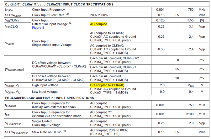

My customer wants to use LMK04828 as a clock buffer to pass 1:9 SYSREF pulses for JESD204B data converters. Since we need to pass SYSREF puleses, not continuous SYSREF, the input of LMK04828 should be DC coupled. While we need 1:9 SYSREF buffer, we have to use CLKin1 which has the ability to pass 1:14 SYSREF pulses. Can I double check with you that is this okay?
By the way, I am not able to find the DC coupling input spec for CLKin, can you help me with the data?
