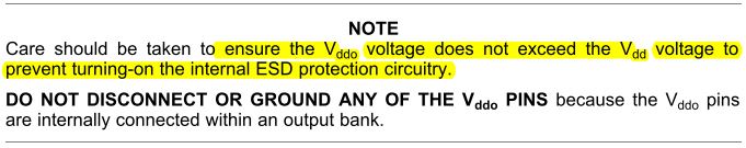

Hi Team,

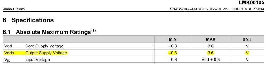

Please allow me to ask you about the power sequence requirement for LMK00105. I found following descriptions in the datasheet which conflicts each other.
Regarding the "NOTE" below, it points out that there is a ESD protection diode between 1.8V and 3.3V. However, regarding the "Absolute Maximum Ratings" for Vddo, MAX is NOT "Vdd + 0.3V".
Which is true and which is wrong ?
Thanks in advance.
