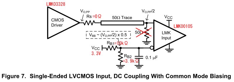

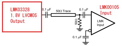

Our customer is planning to buffer LMK03328 1.8V LVCMOS output with LMK00105.
Could you please draw a recommended schematic interfacing between LMK03328 output and LMK00105 input ?
I am thinking the recommendation is the following, based on Figure 6 in LMK00105 data sheet.
Since LMK03328 has output impedance of 50 Ohm, I believe it does not require dumping resistor "Rs".
What is your opinion and please give us your advice.
Kawai
  • Kawai,
    For 1.8V LVCMOS driver, I recommend Figure 7 with the following values:
    * Rs = 0 ohms
    * Do not install 50 ohms load termination (voltage divider) since the 1.8 V output swing is compatible with the maximum single-ended input swing of 2 V.
    * Rb1 = 10 k (pull-up to 3.3 V) and Rb2 = 3.9 k to set CLKIN- to ~0.9 V.
    Alan

  • Hi Alan-san,
    Thank you for your advice. I understood your recommendation is DC coupling as below.
    Even with my schematic above, I think it is still able to work since having enough amplitude for VIH/VIL.
    Would there be any concerns using AC coupling connection ?
    Kawai

  • Kawai-san,
    Yes, AC coupling approach would also work. I just chose DC-coupled interface it is a more common interface for LVCMOS driver.
    Alan

  • Yes, both can drive 50 ohms through DC blocking capacitor, but the AC voltage swing at the load could be close to Vddo/2 due to the voltage divider formed by the driver output resistance and load resistance (both 50 ohms).
    Alan
  • Hi Alan-san,
    I understood that both device CANNOT drive 50 ohms directly from the pin. DC blocking cap is the requirement.
    Kawai
