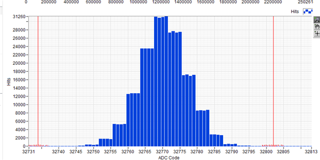

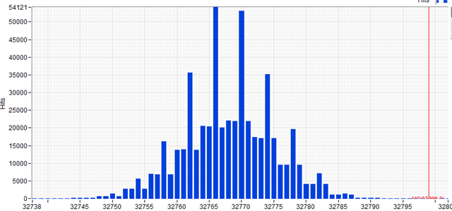

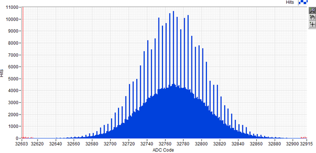

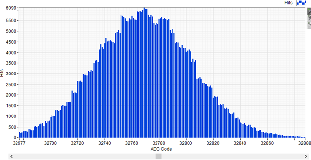

Our customer is using ADS54J60EVM and TSW14J56 to analyze the electrical noise of 1GHz photodetector. When plotting the histogram they've noticed that the histogram is off as it seems that there's a spike in the number of counts every 3 or so bins. This also happens when no input is applied (as can be seen in the respective figures). He tried freezing the offset correction function, and this sometimes appears to solve the problem. However, the behavior remains inconsistent both in time, with consecutive acquisitions showing different behaviors, but also across channels.
No input applied (Good Histogram)
No input applied (Bad Histogram)
Bad histogram
Bad histogram in the next acquisition
