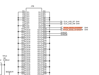

4. What are the necessary FMC pins that I should specify constraints for in my design? For example, FMC pins G9 & G10 (that are supposed to be SYSREF inputs for the JESD204b of the ADC module) are named as "FPGA_JESD_SYSREFP" and "FPGA_JESD_SYSREFN" in the ADS54J60EVM Rev. D schematic. Aren't these differential signals supposed to come directly from the LMK04828? And how the SYSREF signal is sourced to the ZCU102 "rx_sysref" input?

    4. For the ZCU102, use pins G9 and G10 as these signals come from the LMK on the EVM. The ADC has SYSREF coming from the LMK as the EVM default mode.

    If you plan on using H31 for SYNC, you must move the shunt on SJP3 from pins 2-3 to 1-2. By default, the ADC54J60EVM uses pins G12/G13 for SYNC. There are no signals connected to G2/G3. If you need a core clock for the FPGA you must use FMC pins G6/G7. This provides a second clock from the LMK.ADS54J42_Fs_552.96MHz_LMFS_2242.pptx
