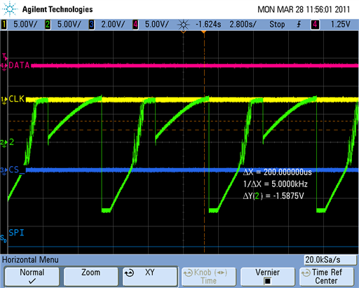

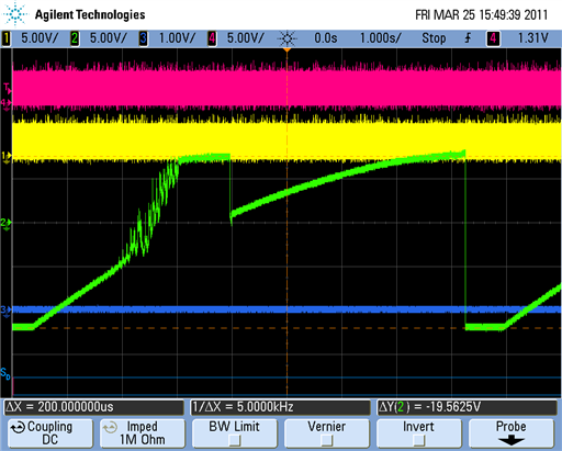

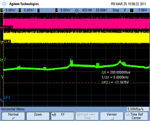

I have a problem with the DAC8718  converter: I can't get a correct output. The 2nd (green) channel in a picture below is a DAC output formed by sending a state of  16bit counter to the DAC broadcast register from 0000h to FFFFh. DAC is powered with +-12V source and reference if 4.096V.
I expected to get a sawtooth style voltage from -12V to +12V with saturations. But the result I have got is far from the desired result. It starts from about -12V as expected but finishes at about +7.5V and the voltage shape is not linear.

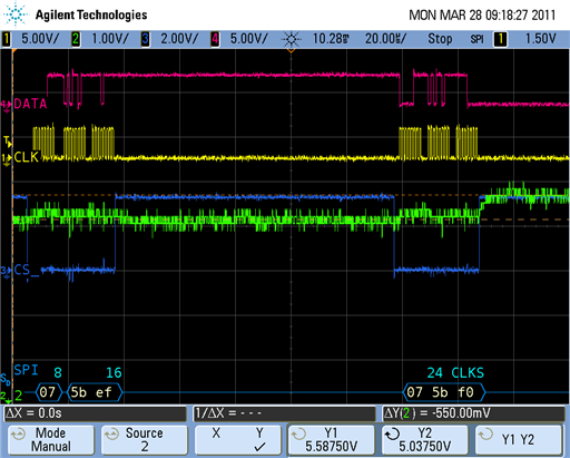

The next picture shows an excange with DAC. The result of sending 23C0h and 23C1h codes is about -9.7V output.
 The next few pictures show the most strange sections of the voltage shape.
 May be somebody knows how can I obtain a normal operation of this converter?
Thanks.

    The more detailed timing diagram for SPI is below.
    The CLK signal frequency is about 1MHz. I think SPI timing far from the data sheet specs limit values.

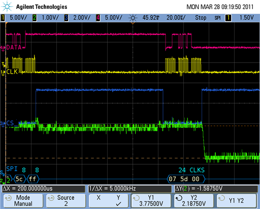

  • Hi Roman,

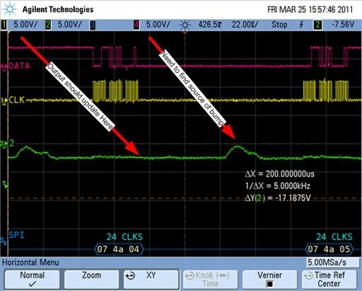

    One last test I thought of which would help narrow down this problem -
     - Rather than stepping up by single codes, could you step up in sets of 10 or 20 codes. This way I can see where the output step is updating in comparison to where we see the output bump or glitch. I posted a picture below to help explain what I am looking for -
    Let me know if this does not make sense.
    Tony Calabria

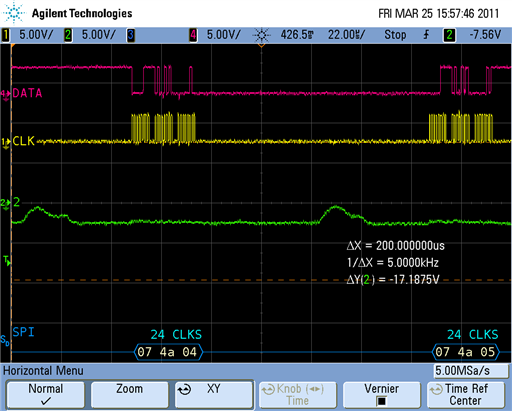

    I understand -12V clipping reason but I don't understand +7.5V upper limit and  nonlinear and nonmonotonic character of transfer function.  In my design I really need a +-10V range. I have not any load on the DAC outputs now. I have removed R35 ... R42 resistors and made my measurements on the free DAC outputs. But I tried to connect 1KOhm resistor between the DAC output and GND for several times. There was no change.
    I think I need to number my pictures :) What picture do you mean? If it is the second one after the schematic then the code range is 0 ... 65535 and repeated 3 times. If it is the third one then I am afraid I cant find a code range relating to this picture but tomorrow I will make a new one and will find the code range for it. I think it does not really matter what place in the output waveform I will take.

  • Hi Tony,
    I just receive your post.
    I've been supposed with such behavior too. Furthermore I have seen a bump during SPI activity (during CS is low).
    I can perform the test you ask tomorrow.
    Roman Ermakov.

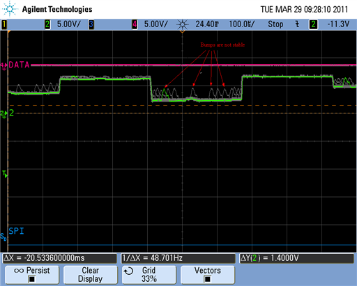

  • Hi Tony,
    I've found a source of the blumps.
    First of all the blumps are not stable. They are moves slowly over all scope so they  are not caused by the SPI exchange.
    Figure 1.

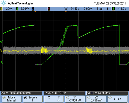

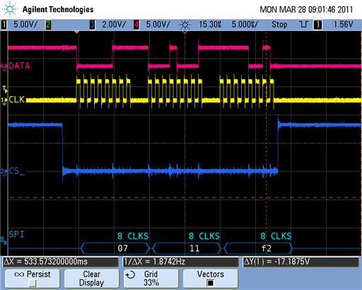

    During mesuaring OffsetA and OffsetB pins in AC mode I detect some  slowly moved noise.
     Figure 2.

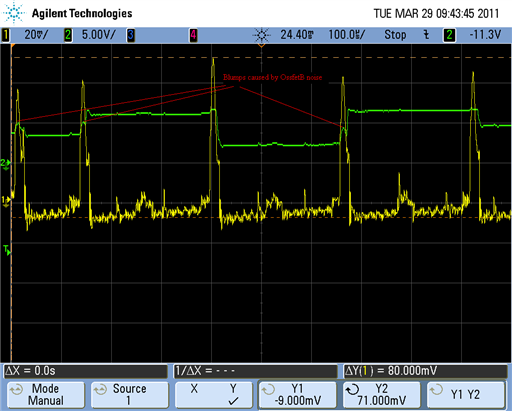

    This noise is the reason of the blumps or the blumps and the noise on the Offset outputs have same source.
    Figure 3.
    I need little more time to process my other results.
    Roman Ermakov.
  • Hi Tony,
    I have attached a PDF with oscillograms and comments for you. Also I have attached an archive with the source and addition pictures.
     2234.DAC8718pics.pdf
    5314.DAC8718pics.zip
    Today I worked basically with the 5th DAC channel (0th channel resistor is on the bottom side of the board and it is not useful to connect probe to it).
    The big noise (up to 80 mV) on the Offset outputs explains the poor matches of this signals.
    Also I implement Input Data and DAC Data registers reading. Both registers contain correct information.
    Roman Ermakov.
