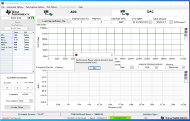

I am currently trying to test the DAC38RF82EVM with the TSW14J56EVM board. I am currently getting this error when I try to load firmware to the device: Set Auto Re-arm Trigger Params in DLL WRITE_REGESTER_FAILED Write register operation failed. I do not know how to solve this error so any guidance on how I would go about fixing this would be extremely helpful.

    Please verify jumper JP11 has a shunt between pins 1-2, JP12 has no shunt, and JP4-JP7, JP10, JP13, JP16 and JP17 have a shunt between pins 2-3.
    Please send screen shots of the GUI after the GUI first opens, then after selecting the ADC ini file, then after pressing capture. Can you also monitor the current and let me know the consumption is after each of the steps?
    Are all three boards doing the same thing? When did you get these boards?
    Jim
  • Jim,
    All shunts are in there proper locations as specified above. The current draw remained constant throughout all steps you asked me to preform at 0.540 A. I attached the screenshots below and it is still giving me the same error. I checked with other engineers and they told me we received these boards around mid-May. All three boards are giving me the same error.
  • Jacob,
    Do you select a ini file after clicking on "OK" in the screen shot you sent? This is required to download the firmware. Do you see the following ini files after clicking on the Select DAC green drop down arrow?
    If so, what happens after you select the ini file? Please send a screen shot of that.
    Jim
  • Jim,
    I do and after I select any of the .ini files I get that Auto Re-arm Trigger Params in DLL WRITE_REGESTER_FAILED error again. Then when I try to click the file again all it says is download firmware.
