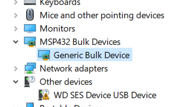

TMAG5170EVM + SCB controller to your computer, cannot connect to eval module

So its not working. Tried the suggested driver update in the help section. But not sure if this is the right one. Even Google cannot find anything usefull to help out.

    Thanks for reaching out for this.  Did you attempt the firmware upgrade yet?  It appears you are using the newer GUI, which will require updating the firmware before the GUI will connect correctly.  To do this, please press the reset button while shorting the DFU pins on the SCB at the marked vias (located near MSP432).  You should see that the LED nearest the MSP432 does not light up.  Then in the GUI, click File->Program Device.  The GUI will then load the latest firmware onto the controller board and should restart.
    In the event that it does not recognize the controller board after you do this, I would recommend first trying to change USB ports.
