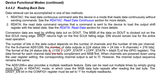

Recently I use ads1299 in my project. I found few "0" data in my sampled data,  about 1-3 points/min, I use 4khz sample rate.
So I check the status bits every "0" data, and the results show when I get  0 data, the fisrt 4 bits are not "1100".
Can you give me some advice about this?
