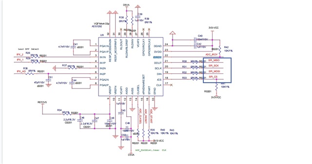

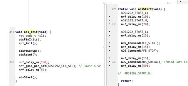

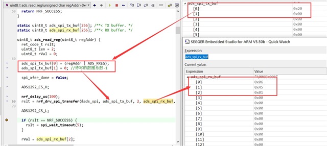

   one customer named MegaHealth hope TI can supply a sample code to read ID register. they could not correct read ID register. the correct content of ID register should be 0x53 according datasheet whereas customer get different ID content every time if they read ID register. they said that they can read and write other register correctly. below is their schematic and code. the basic information as below:
  •  use ADS1292 internal clock and frequency is 512K.
  • SCLK frequency of SPI is 1MHz.
  • SPI running in mode 1
  • Data rate is 250Hz.

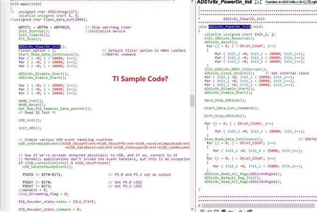

  • Does TI has a sample code? customer said that they reference TI sample code. but I could not find it form TI web.

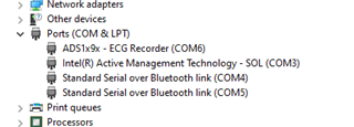

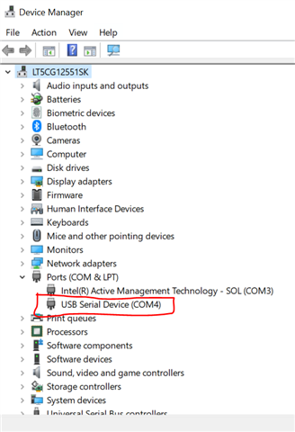

  • the USB driver is not same with EVM user guide. my USB driver as below. my OS is windows10.
  • there is error information when I starting ADS1x9xEVM software.

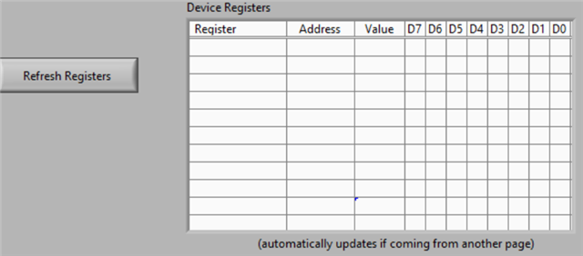

  • there is blank if I refresh register. refer below figure.
