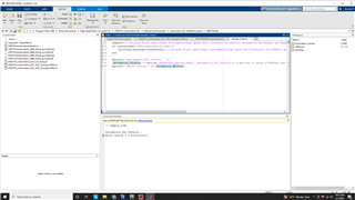

  • Thank you Jim!
    Attached is the screenshot of the MATLAB command window after I run the sample code.
  • Aravind,
    This from our software team:
    "The customer is getting the version number of the Automation DLL without any error i.e. 3.2 is the version number here. By mistake, in the fprintf statement, it is mentioned Error_Status instead of Automation_Version. But the script is executing without any issues on the customer PC. Kindly ask the customer to edit the ADC Example available at the following location according to the use case and try it without changing the directory. The example should work without any issues".
    "C:\Program Files (x86)\Texas Instruments\High Speed Data Converter Pro\HSDCPro Automation DLL\Manual and Examples\Automation DLL Matlab Example\64Bit Matlab\HSDCPro_Automation_DLL_ADC_Example_64bit.m"
    Jim
  • Thank you Jim! That worked and I was able to run a few other commands without any error message as well. Thanks for resolving the issue.
