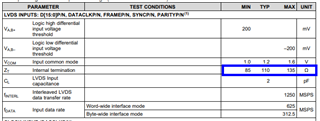

Hi Louis,
Here are my feedback:
1. D15p/n to D0p/n are LVDS inputs. There should not need be any series resistances of 22ohm as these resistors will lower the LVDS swing and also change the LVDS bias. The LVDS inputs of the DAC384x have internal termination of 100ohm. If you want to leave the resistors as placeholder, change 22ohm to 0ohm
This also applies to parity pins, sync pins, and frame pins.
2. unused DAC output can be connected to ground directly
R303 and R667 can be 0ohm
Everything else looks fine to me. Thanks.
