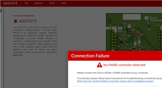

  • Hi Aaron,
    The customer loaded boot_usb.inf in accordance with this instruction. However, below message still appears.
    What should he do?
    Shota Mago
  • Hi Aaron,
    PAM board can be recognized but EVM still can NOT be recognized...
    He clicked on File --> Program device and then selected the ADS1115. Then, when GUI is restarted, below message appears.
    What should he do?
    While, he noticed that driver name has been changed to "Generic Bulk Device" and he updated the driver in accordance with FAQ instruction.
    Shota Mago
  • Hi Shota,
    It looks like the EEPROM on the EVM is not programmed. To help with programming the EEPROM, I have pasted a snippet from a similar E2E post below
    To program the EEPROM, go to the Options menu to manually connect to the COM port that the EVM is set to use.
    From the Options drop-down menu select Serial Port.  You should see an option box similar to what is shown.  Search for and select a COM port that displays the PAMB board in the “Ports” drop-down list and click OK.
    You will be issued a warning that the connection is to an unknown device, but that is ok.
    The EVM may appear to connect properly, but we still need to program the EEPROM so that the GUI will automatically connect when the GUI starts.  To fix this:
    • With the GUI open press CTRL+ ALT + D (this puts the GUI into developer mode)
    • Click Tools -> Write EEPROM
    Aaron Estrada
