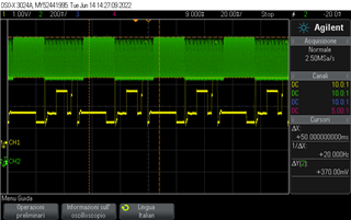

    As a result, now I noted that AINN oscillates with a frequency of about 8kHz and the same happens on CAPN (input of the modulator). This oscillation (360mVpp/8kHz) is removed bypassing the AINN protection resistor. Also the acquisitions of my ground reference (this reference is input to a MUX and then filtered as well as offset by 1V; same offset on AINN) reflects this observation: in the first case I can read about 160mV; in the second case 534uV.
    Observing the attached oscilloscope screenshots, you can see that AINN (1V nominal) seems to be clamped at about 0.65-0.8V.
    Furthermore, I observe MFLAG signalling that modulator is generally overdriven. This is likely due to the fact that the oscillations on AINN cause modulator's overdrive. Unfortunately, also with AINN resistor bypass, MFLAG activates sometimes, even though I couldn't find any noticeable reason for that.
    Finally, I observed a 60mV voltage drop across the AINN protection resistance, pointing out an average 40uA current flowing into AINN pin , when I expected something like 1nA as specified in the datasheet.
    NB: all inputs were always within the acceptance range (AVSS+0,7V to AVDD-1,25V). No out of range input was ever provided to this device.

    all figures below refer to the presence of 1k5ohm  rprotection resistors on both AINP and AINN.
    Legend: CH1 = AINP (yellow); CH2 = AINN (green)
    Figure 1 - AINN wrt AINP
    (during SINC acquisitions CM is lower and clamping seem to occur; during FIR acquisitions CM is higher and clamping seems not to occur)

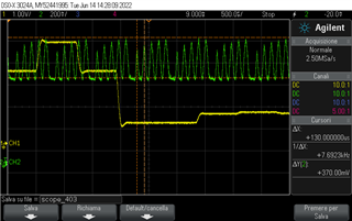

    Figure 2 - AINN during FIR acquisition
    Figure 2

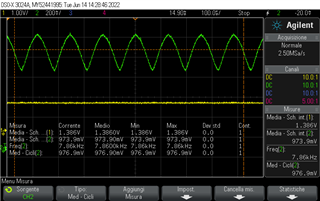

    Figure 3 - AINN during SINC only acquisitions
    Figure 1

    Figure 1 shows the overall behaviour while Figure 2 and Figure 3 are details of the same waveforms in Figure 1.
    Figure 2 zooms the part where I'm performing FIR/4kSpS acquisitions (I get the first nDRDY negedge after SYNCing the ADC to void filters, thus AINP is fed by the same signal for 16ms + 250us Sallen-Key LPF settling time)
    Figure 3 zooms the part where I'm performing SINC/64kSpS acquisitions (I get the first nDRDY negedge after SYNCing the ADC to void filters, thus AINP is fed by the same signal for 450us + 250us Sallen-Key LPF settling time).
    The oscillations observed are all 8kHz.

    Anyways, I'm really confused what I'm looking at. From what I can tell AINN is oscillating and not expected by you. For AINP, it looks like a DC type voltage that can change to some piecewise waveform that is periodic and this is expected. Is this correct?
    MFLAG tripping is an interesting sign but expected given the waveforms. AINN = around 0.5mV, and AINP = 5V max, so we're violating every FSR option in the device. I'm trying to understand if AINP is expected and what AINN is supposed to be. Looking at the schematic in the post that was created from this one, it looks like voltage divider into a buffer that provides 1V_DC, but that would still exceed FSR if that was expected.

    AINN input scale is 200mV/div. Given that, AINN results an average of 950-1000mV with 350mV peak-to-peak voltage. MFLAG triggered active/inactive because many times the difference between AINP and AINN went slightly overrange and the root cause was AINN oscillation.
    1Vdc is generated and provided both to AINN and AINP to make the resulting waveform stay between 1V and 3.5V in order to prevent violations of the input limits (VSS+0.5V; VDD-1.25V), since the ADC AVDD is 5V and AVSS is 0V.
    It's true that Figure 3 points out a signal exceeding 3.5V, but it was the only one. The waveform is periodic because it is given by an external analog MUX sweeping 32 different inputs, that are all fixed dc.
    MFLAG was correctly activated, not only when the input was violating input limits, but whenever the input differential voltage was exceeding Vref/2. The latter violations were all due to AINN wide oscillations.
