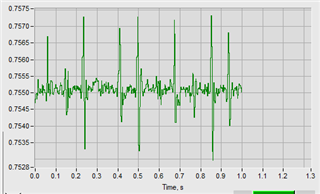

  • Dear Bryan,
    The major issues were related to SPI driver which was programmed for 24-bit read and write. While issuing 8-bit commands, the remaining 16-bits of read/write variable were kept zero. Since there are commands like WAKEUP which have all 8-bits zero, the issued dummy zeros were being misinterpreted as commands like WAKEUP.
    Now after modifying the SPI Driver for read/write of selected 8-/16-/24-bit variable, all the signals are consistent and now I am able to get data on all the 4 devices (continuous cycling on first three devices, each with one channel, and multiplexed cycling on fourth device for four channels).
    However, there are some issues in data acquired from the continuous cycling as shown in the Figure 1 that shows some spikes. On investigating this, it was found that though most of the time DRDY signal is clean (as in Figure 2), at times it looks corrupted (as in Figure 3).Figure 1
    Please suggest how it can be corrected?
    With kind regards,
    Somayya
  • Hi Somayya Ammanagi,
    Have you looked at this signal on a scope to see what is going on? Is it clean or does it have a lot of noise?
    DRDY is an output from the ADC, so there is no reason it should be toggling like that. In the third image I see what looks like two DRDY pulses that are about 40 units part. Assuming the timescale is the same as before, that is 40*0.13 = 5.2 us, or about 200 kSPS. The ADS1256 does not sample this quickly, so I cannot think of any circumstance where DRDY would toggle so quickly like that.
    I would check all of the communication signals with an oscilloscope and make sure they are clean.
    -Bryan

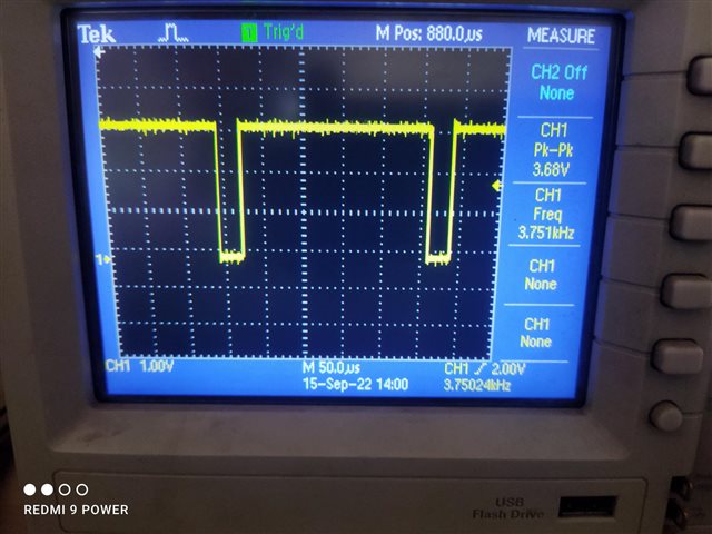

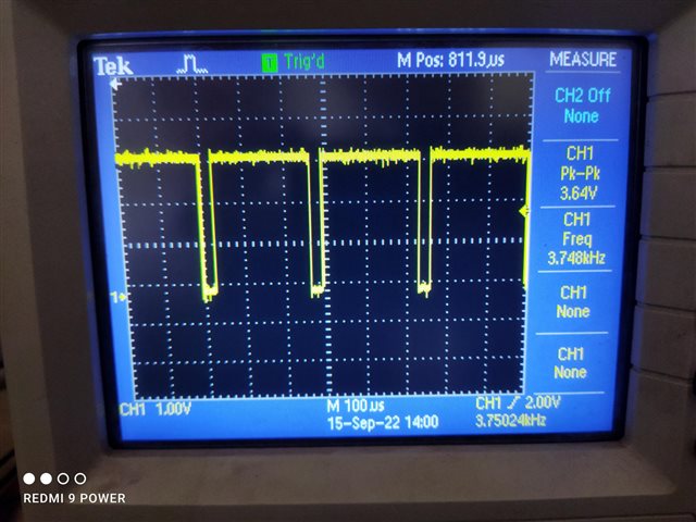

  • Hi Bryan,
    Apologize for the delayed response.
    Below are the oscilloscope screen shots of the DRDY signal to show the noise levels on them.
    The issue of spikes in DRDY is appearing only in 1st and 3rd devices only not 2nd device.
    When the issue occurs in DRDY, correspondingly the disturbance in SCLK signal will show up in terms of  bit conversion taking only two CLKIN periods instead of CLKIN clock periods as shown in one of the previous pictures. But I have not observed any missing SCLK pulses like 23 instead of 24 pulses; may be it may not have shown up whenever we have observed.
    With kind regards,
    Somayya
    Yes, my initial thought was that there some cross-coupling between the relative high frequency SCLK signal and the DRDY trace. This would make sense since there are no circumstances under which the ADC will output a DRDY pulse that is ~1 SCLK period. There was also some dependency on SCLK frequency, as the number of unwanted DRDY spikes reduced when you reduced the SCLK frequency.
    My best suggestion as this point is to review your board layout and see if there is any way that these signals could be coupling. If you have had to rework your board, I would also check for flux residue and improper solder joints.
    I would also try to capture the weird DRDY transitions on the scope, along with the SCLK signal, to see if there is any correlation.
    -Bryan
