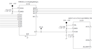

I am using a circuit that combines your TMUX1308QBQBRQ1 and ADC121C021QIMKX.
Is it possible to eliminate the external capacitor on the VIN side of the ADC121C021 and substitute a capacitor on the input side of the TMUX for the VIN capacitor?
In the image, I want to delete C139.
thaks,
Katsuya.
  • Hi Katsuya,
    The short answer is that it depends. Since this is a SAR ADC, you need to take into account input settling. What is the acquisition time you are running at? Please note that the input should be fully settled within 0.5LSB by the end of the acquisition time. With shorter acquisition times, this requires the use of an opamp+RC filter to help facilitate settling. Also, what is driving the MUX? schematic image seems to be cut off just left of the MUX.
    Aaron

  • Hi Katsuya,
    With a larger acquisition time, the capacitor placed in front of the MUX should be fine. What are the voltage divider values? I would keep the resistor to GND as low as possible. Perhaps at 1kohms or less. The larger the source impedance the harder it is to settle the input. So if the resistor to GND is kept at 1kohms with the capacitor in parallel, you should be able to drive the ADC just fine.
    Aaron

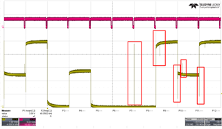

    I took C139 of the schematic attached to the original question and checked the waveform, and found that noise is generated when the MUX channel is switched. Is this noise caused by GND being too large?
    Fortunately, there is no noise in the reading, but I am concerned about the cause.
    ch1:MUX output
    ch2:ADC I2C SDA
    Katsuya
  • Hi Katsuya,
    It it likely that the noise you are seeing is charge injection from the MUX. As long as the MUX output is stable and settled before the end of the acquisition phase, you should not see an error and that is likely why you are not measuring these transients.
    Aaron
