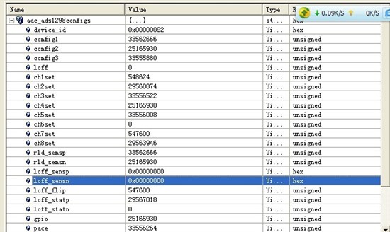

    and i can get the device id_92, and loff_sensp and loff_sensn are 00.
     here i only check out those three regs , others not.

    And another good news is the configure regs which I read back is correct.
