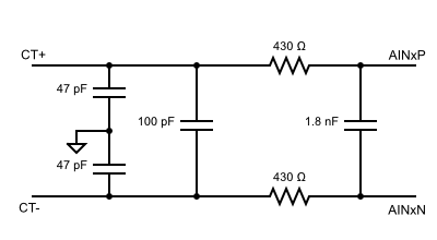

The company I am working for is using the ADC ADS131M06 for sampling the output of a current transformer (CT) that has an integrated burden resistor, therefore outputting a voltage of 0.333V over relatively long twisted wires of around 1m. When the CT is used in a noisy industrial environment, the output of the ADC is corrupted by environmental RF noise, most probably due to motor drivers (VFDs) located nearby. Other channels used for sampling the high-voltage (with a resistive divider) are not affected by this noise, indicating the noise is likely coming from the CT cables and not from the PCB itself. The signal of interest is located between 1Hz and 10kHz, the noise is in the range of 20-100kHz. The electrical design that is used today between the CT cables and the ADC can be found in attachment.
- Can something be done on this circuit to improve the noise immunity?
- For now, we use the PGA with a unity gain, while we could go to a gain of 2, maybe 4. Would increasing this gain be beneficial in our situation? My guess is it will also amplify the noise...
Thank you very much in advance.

    Changing the input filter:
    Normally, I'd recommend reducing the sampling rate but you have a bandwidth pretty high in frequency so its not really an option. In reality your first option is to change the input filter and the second is to develop some digital filtering. Doing an FIR, if you can handle the delay, or adding another SINC (moving average of samples) lower in frequency compared to the ADC could help with this issue.
    Otherwise, I'd add some resistance on the input to help move the common mode filter down in frequency and lower the differential one as well. You could stand to make the common mode caps at 100pF and see if there's improvement. In reality, the noise is really close to your frequency of interest and upgrading passive component tolerances might be necessary and might bump up cost more than your other methods, so be weary of that.
    Small note about gain, yes, gain usually makes noise worse and more prominent.

    - Actually I'm not sure of the efficacy of my common-mode filter circuit in its actual shape. Wouldn't it be better to have the kind of topology described in this topic: e2e.ti.com/.../faq-delta-sigma-adc-anti-aliasing-filter-component-selection , i.e. a single resistor on each input with a capacitor to ground and to the other input ?
    After some thought I'm not sure about the "true" frequency of the noise either, I might catch very high frequency noise but aliased since it is sampled at 32kHz. A well-designed common-mode analog filter might filter this.

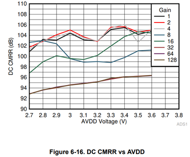

    - Regarding the higher gain, does increasing the PGA have any effect on the CMR? Or will it simply amplify the (common-mode) noise and the signal?
    I agree that filter topology was better but I was under the assumption you couldn't change your schematic, only depopulate or replace components. If you have the ability to follow the advice in the post, I suggest that.

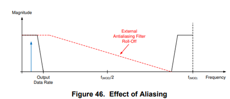

    For aliasing I like to use this picture (its from a different datasheet):
    As a reminder, the f_MOD of the ADS131M06 is something like ~4MHz and your cutoff is something in the ~100kHz (if memory serves me right) range so we should have quite a bit of attenuation for anything to alias back.

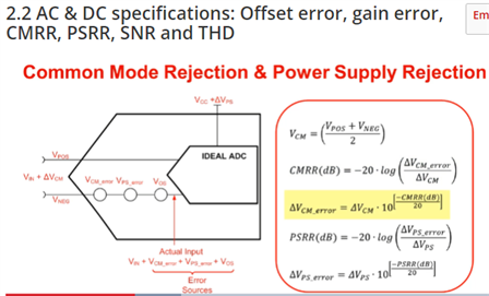

    In short yes but its relatively the same for low gains and lower (worse) at higher gains (>8). That being said, you can probably do some quick math and see that some other source of error will be pretty small compared to something else like offset (picture below from TI Precision Labs video training series: https://training.ti.com/ti-precision-labs-adcs-ac-dc-specifications-offset-error-gain-error-cmrr-psrr-snr-and-thd?context=1139747-1140267-1128375-1139102-1128657
