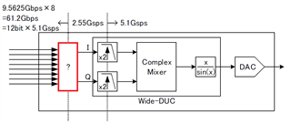

Jim,
Thank you very much for providing the slides.
But, my customer would still like to know how to set the portion framed in red below, between SerDes input and I/Q data streams
Could you provide some instructions, please?
K.Hirano
Hirano-san,
See if the attached document helps. The user will send 4 lanes of real data to DUC 1 (I data) and 4 lanes of real data to DUC 2 (Q data). The lanes are swapped on the DAC38RF82EVM GUI setting since they are routed this way on the PCB.
Jim
