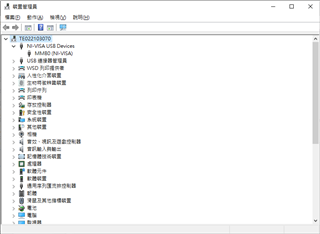

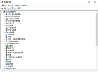

  • Hi ChienChun,
    I can see the MMB0 device in my Device Manager  now.
    After i open the GUI of ADS1299 , the device will disappear like the picture. I checked whole Device Manager. It not turn it to anything else or unknown device.
    I using the other computer that system is windows 7 to install the ADS1299EVM's software. I can see Install the USBStyx Driver.
    But it still didn't work. It show the same error message like before. DSP not ready ....retrying.
    And i can't see the device in Device Manager.
    Thanks for any help.

  • Hi ChienChun,
    I can't see the "Ports (COM & LPT)" after connect the EVM.
    I only see the "NI-VISA USB Device" -> "MMB0 (NI-VISA)" like my previous post.
