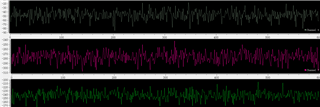

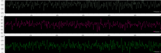

The power offset and noise of 1299 are relatively large, and the offset of 8 channels is different. Why do they have different bias problems
Is there any way to improve bias and reduce noise
Test the short circuit and internal noise. When the conversion rate is 250 SPS.
The relevant AD values are as follows. The noise is about ten microvolts. The channels with different bias are different. Some channels are 25uV and some are about 150uV
When the conversion rate is 4K SPS
64-pin grounding and floating, this problem has not been improved.
PCB wiring is separated from analog and digital parts.

    Do you have ADS1299 evaluation kit/board(evm)?
    Please use ADS1299 evaluation kit/board evm to compare&validate the noises seen in your system.
    Noises could come from many variety of sources, power supplies, PCBA components/design/layout, cables/wires, UUT(unit under test)/UUM(unit under measure).
    Pease check the Vref and AVDD to make sure they are clean.
    What do you mean by " rotational speed"? and What do you mean by " the data cannot be read completely,"?
    It's highly suggested to use ADS1299 evaluation kit/board(EVM) to co-validate/verify with your designs&configurations as well as SPI communication.

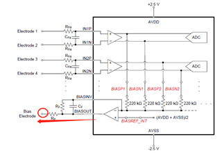

    In addition, whether the common-mode feedback output needs to be amplified for better effect, because the effect of direct BIAS output is very poor now
  • It is a continuous read mode, and the buffer has 27 bytes
    Demo board won't exhibit exactly the same as the noise data in the data sheet.
    It's suggested to use BIASOUT and customer will need to tune the related R, C and the BIASPx and BIASNx based on the product design an through experiment&tests&data collection&analysis&V&V.

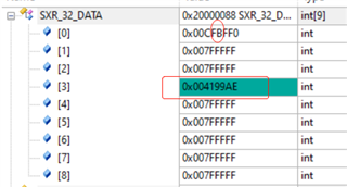

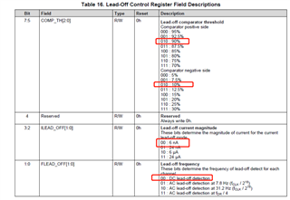

    The following problem was found regarding electrode detachment detection: different thresholds were configured, channel 3 could not be detected at all, after disconnecting all electrodes, other electrodes had no AD value change, but channel 3 still had AD data fluctuation. No short circuit problem was found in hardware testing, and all channels were normal when testing signal generator.
    Help analyze the possible causes and improvement measures.
    Ok, you are using one of the datasheet page 31 Figure 36 DC Lead-Off excitation options.  May I ask do you use a) or b) or c)?
    It seems noises and interferences from environment, please check the power source(s), cables(length, shielding, material), grounding(common ground, any ground loop) and electrode/patch contacts.
    What is your Unit Under Test(UUT)?  Have you tried it with an ECG/EEG simulator?
    Do you use BIASOUT?  If not, could you try use BIASOUT?
    and you may want to try different current and threshold settings as the impedance for some particular electrodes/nodes/location might be different.
    It's highly recommended to use an ADS1299EVM with an ECG/EEG simulator to test first.

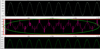

    In addition, we found that some channels would have abnormal data or waveform and poor contact, whether the internal switch had poor contact or other possibilities, how long it was used in the 1299 market, how much it was used, and whether other customers reported the same problems.

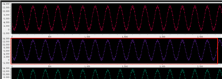

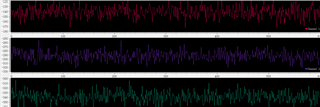

    Bad channel data is as follows:
    I need more time to look at your case, will get back to you before 2/17.

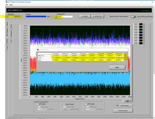

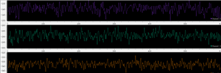

    Please see baseline noise floor when all(8) channels are shorted and Output Data Rate(ODR)=16k SPS-
    And, it can stream data at ODR=16k SPS without error or data drop, see x-axis, 32000 data collected for around 2 seconds
    and data can be output&saved correctly-
    8 channels shorted 16kSPS.txt2260.Device_0_Volts.xls
    It's suggested to use EVM with an ECG simulator as primary reference and help during evaluation and R&D.
