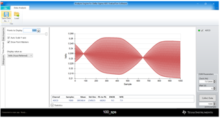

i took a DC measurement with INPMUX: temperature sensor (~0.200±0.001)V
                                                    REF: internal AVSS/AVDD      /   Laboratory power supply (5V)
When taking the measurements i see a strong oscillation which only occurs when i use an external power supply. When using the EvalBoard on board power supply i don't see the oscillations.

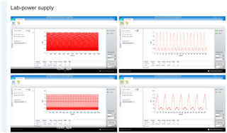

Laboratory power supply 5V   &    REF: 5V lab power supply
9V battery power supply  & REF: AVDD/AVSS

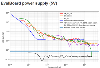

external power supplys                                              &                          EvalBoard power supply:
Questions?
Why are the oscillations appearing ONLY when i use an external power supply ? Do i need to connect my power supply somewhere else (AIN0&AIN1 at the moment).

  • Hi Marcel Beck,
    I was not clear in my last post
    The bridge no-load output voltage will be 4.5V, which is too large for the ADS1261 unless you level-shift this voltage down somehow
    The bridge no-load common-mode voltage will be 4.5V when the excitation voltage is 9V. The differential bridge voltage will be 0V in this case, but the absolute voltage on the (+) and (-) leads of the bridge will be 4.5V when the bridge is perfectly balanced. This is too large for the ADC to support in most cases - see equation 5 in the datasheet
    Are you able to power the ADC from the same source as the bridge / VREF? At least for the first setup where you are using the lab supply?
    Here I was asking if you can power the entire setup with the lab supply: bridge, ADC, and VREF. This will require some minor modifications to the EVM. I am wondering if there is an issue with the different power sources interacting with each other
    Also, why do you want to power the bridge from a lab supply but use the ADC analog supply as the reference? Then you no longer get the benefit of the ratiometric reference voltage, so any error in the excitation voltage will be seen in the output. It does not seem like your lab supply is very high performance.
    -Bryan
  • Hi Bryan,
    i talked with an expert on that topic and you are right, the common-mode voltage exceeded the ADCs range. That was the reason why i got those oscillations.
    Thanks a lot for the patience and the fast answers. Keep up the good work Slight smile
    Marcel

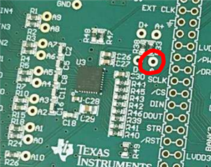

  • Hi Marcel Beck,
    The most direct way to power the ADC from an external source is to tie into the test point just before the AVDD pin. This is shown in the image below
    You would also have to remove R33.
    There is also circuitry on the EVM to apply external power - see Figure 20 if you want to choose this option.
    In general you just need to follow the schematic to make sure you are powering everything you need to power if you choose external supplies.
